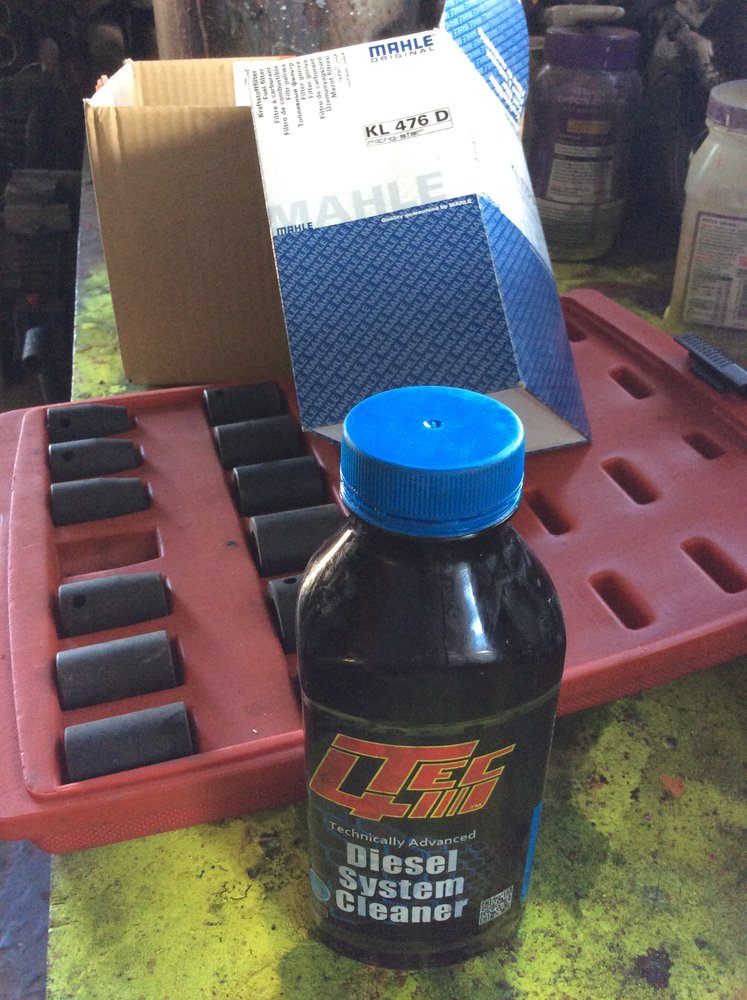

Put £10 of petroleum in the my partners sharan just to get her to town where the prices are sub £2.00!
Could of got away with it ,as usually there’s a fair bit of diesel in there,drove home 4 miles,no problem,still hadn’t twigged
.half hour later she’s trying to start it to go out,then I realised.
Tried siphoning,then a hand pump,then get my workman to take me to the Land Rover garage to borrow a 12v job,still no fluid movements,so rip the interior out ,plus fuel sender and slip a pipe down the side,new filter,filled with conditioner,emergency gallon into the tank,she starts instantly,runs smoothly,put the interior back together just in time for school pick up,Helen comes home after doing her journey in my van with a cracked windscreen,sod all money earned today.
.half hour later she’s trying to start it to go out,then I realised.Tried siphoning,then a hand pump,then get my workman to take me to the Land Rover garage to borrow a 12v job,still no fluid movements,so rip the interior out ,plus fuel sender and slip a pipe down the side,new filter,filled with conditioner,emergency gallon into the tank,she starts instantly,runs smoothly,put the interior back together just in time for school pick up,Helen comes home after doing her journey in my van with a cracked windscreen,sod all money earned today.
