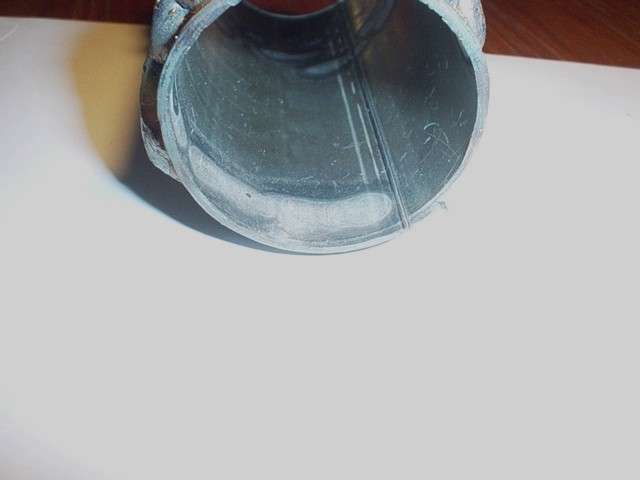

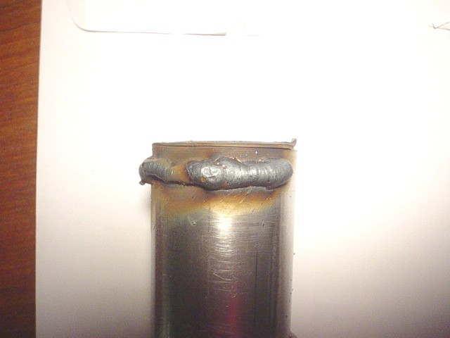

Could you please review this weld. It is on 16/17 ga exhaust tubing. I used 0.030" Mig wire with C25 mix at 15 cuft/hr. It seems a bit fat and high to me and even after experimenting with different wire speeds this is the best that I can get. Does the penetration look OK? Thanks.
Nash
