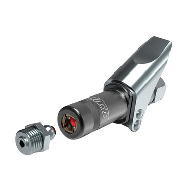

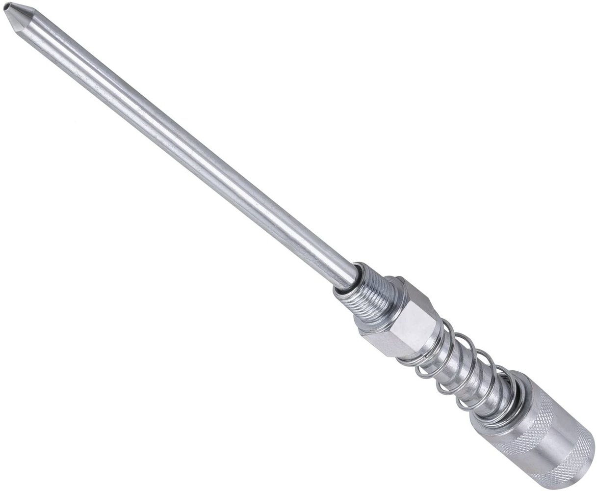

they could be usefull for hard to reach prop ujsIf you have a needle nozzle they work absolutely fine by pressing them Into the end of a zerk fitting (grease nipple).
Something I had to do regularly on aircraft because the locking end simply wouldn't fit or no wiggle to release them.
