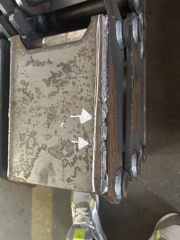

no they don't. random defects and waved linesAssuming it's a simple start point to end point in one linear movement in the robot program then the robot is unlikely to be the problem (unless it has a mechanical issue)
Are the defects always in the same place?
nope were already welded manually. Also manually anyway we have some little issues. We thought about that the cause could be the wire itself but looks unlikelyAre the round bushings welded at the same time ?
