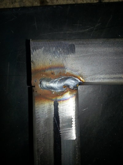

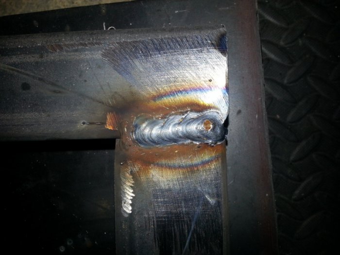

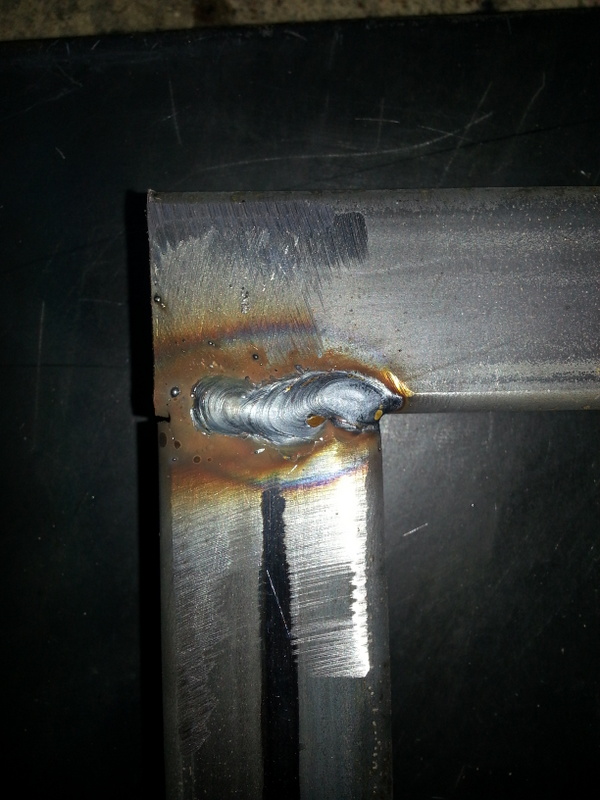

Received my Portamig 215 last week and after a couple hours messing around thought I would start on some box section (40 x 40 x 2.5) for a welding bench.
I have never used a welder before but have been reading this forum for several months, prior to making my purchase. I have attached a couple of photo’s and would appreciate any comments. Settings are:
Coarse 2 Fine 2 Wire 3.9
Using 0.8 wire
LPM 12 at the nozzle
Hobbyweld 5 (93% Argon - 5% Co2 - 2% O2)
I did use the setting calculator and that produced the following setup
Power 7 Wire 4.9 - so I am guessing I might be a little slow on the wire speed.
Thanks in advance

quite straight too !
