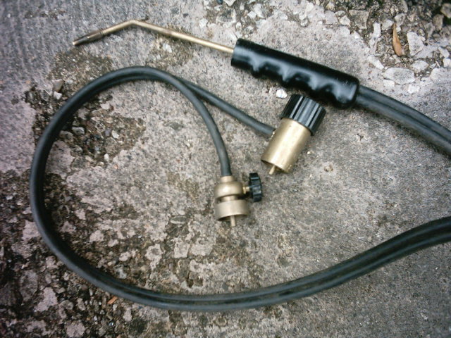

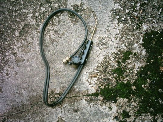

Can anyone identify this item please? I think it is some sort of cutting attachment. The words Bernz O matic Medina N.Y 14103 is written on the handle. It refers to propane valves & oxygen valves on the instructions on the handle.
As above. I believe B&Q sell them (or used to), and Screwfix also have some Benzomatic stuff. They are used on little disposable bottles like the oxy/mapp kits you can buy.
According to the instructions it can be used for cutting, you just wind open the oxygen regulator once you have the work heated up.
Never tried this, and would not vouch for how long your disposable bottle would last, (I suspect about thirty seconds!)
Yep. Was my first gas kit, way back when. I think Halfords still do the bottles. Fine for brazing with propane or MAPP.
I think a couple of months later I went for a "proper" torch and a bigger Oxy bottle and reg before finally getting an acetylene bottle. With a good torch, MAPP and a big Oxy it welded fairly well.

Assuming that the oxigen bottles are still available, are these devices SAFE to use. The reason i ask is that a welding supplier in Sheffield advised that an item like this (using oxy) is NOT safe to use without flashback arresters and could explode.
As the majority of small portapack sets that are sold new dont have flashback arrestors on the lines, then you are just as safe as them. I bought one that took boc's smallest size bottles but no arrestors, so its not just diy stuff from halfords we're talking here.
As if to if I want to use a portapak with no flashback arrestors, umm not very much , for the price of a pair of flashback arrestors Id rather not destroy my workshop when something goes wrong.
Flashback arrestors only come into play when something has gone quite wrong, normally a oxy/acetylene setup will never need them. However imagine severing your lines accidentally when something falls on it, and igniting the leak. As you hear the flame travel down the line, thats your cue to run if you don't have any.
I would have thought its more important to have them on the fuel cylinder (the acetylene/mapp gas or whatever) as while oxygen will make a fuel fire burn very very hot, with the complete absence of fuel, there will be no fire.
