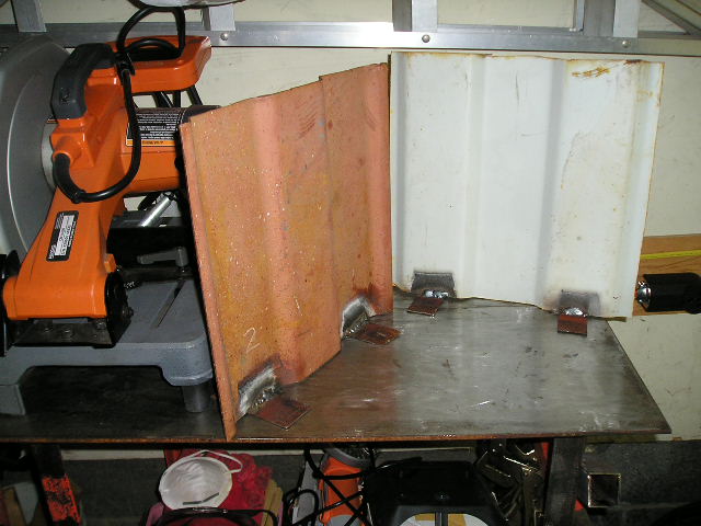

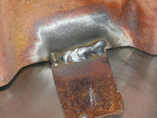

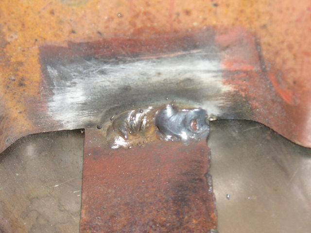

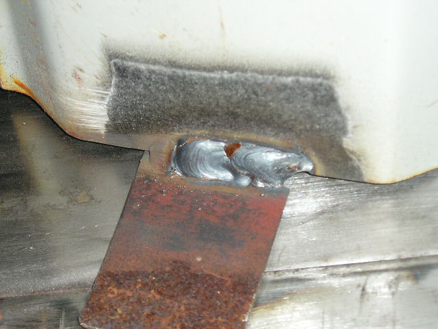

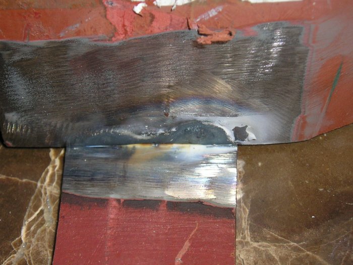

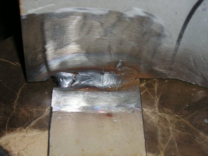

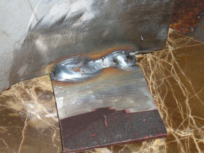

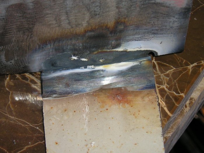

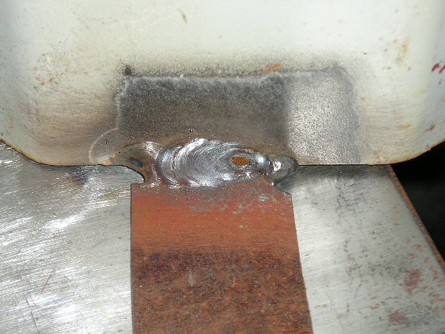

I finally got the gas connection sorted out and started playing with my Clarke 180EN. Tried some simple beads on .040" (1 mm), .100" (2.5 mm) and .250" (6.35 mm) stock just to get a feel for it. I know it's not rated for the .250/6.35 mm without proper V-preparation, but I was just trying to get a feel. I discovered the following.
1. Someone should invent an interlock so you can't start welding when your gas is off. I turned the gas off five separate times; I forgot to turn it back on five times. In the US, we would say that's batting 1000, but that's a baseball (rounders for you UK guys?) reference.
2. I'm assuming that the proper sequence to increase power is not what is stated in the manual, but rather 1 min, 1 max, 2 min, 2 max, 3 min, 3 max.

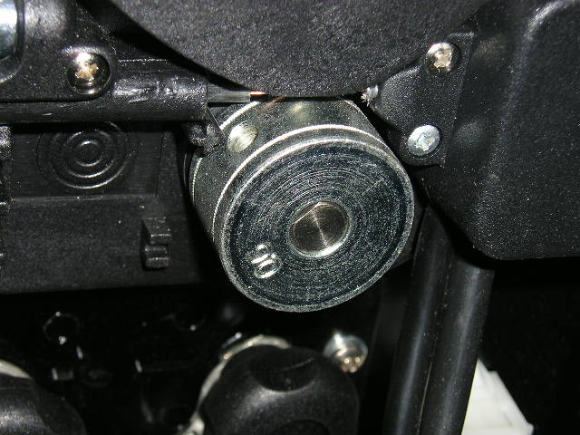

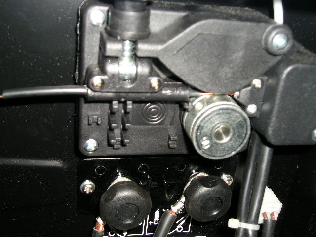

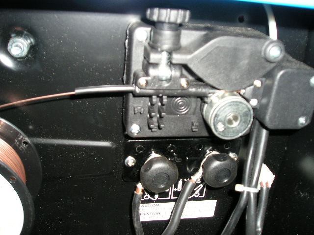

3. With the feeder roll positioned for the correct wire diameter, the wrong wire diameter will be visible. This seems to be because the thickness is stamped on the side of the roller nearest the groove it represents, and the Clarke uses the slot farthest from the side you can view. It took me a few minutes to realize this.
4. Dripping molten steel is hot, and it tends to go places it's not supposed to, like inside my short socks. This would not have been possible had I put on the blue jeans I had brought downstairs to wear for my welding practice, but I was a bit lazy and thought, "What's the worst that can happen if I leave my shorts on?"
5. Higher current doesn't make it easier to see what you're trying to weld.
6. Welding .040" steel with 0.8 mm wire requires you to move the torch faster, even on 1 min. It's probably better to switch to 0.6 mm wire for this.
7. It seems the higher the current, the more critical the wire speed. At 180 amps (well, you knew I had to try it out; why buy a 180 amp machine if you're not going to at least try welding at 180 amps?), I was set a bit too slow and was getting a fair amount of sputtering and unpleasantness. Fortunately, speeding it up to the next setting was close to perfect and the sound really became the hissing that I keep hearing about. Did I get into the magical spray transfer mode?

there is a lot of mill-scale & rust at the weld site. You must get back to bright metal, use a grinding disk not a wire wheel. The welds show evidence of the rust & scale exploding .
