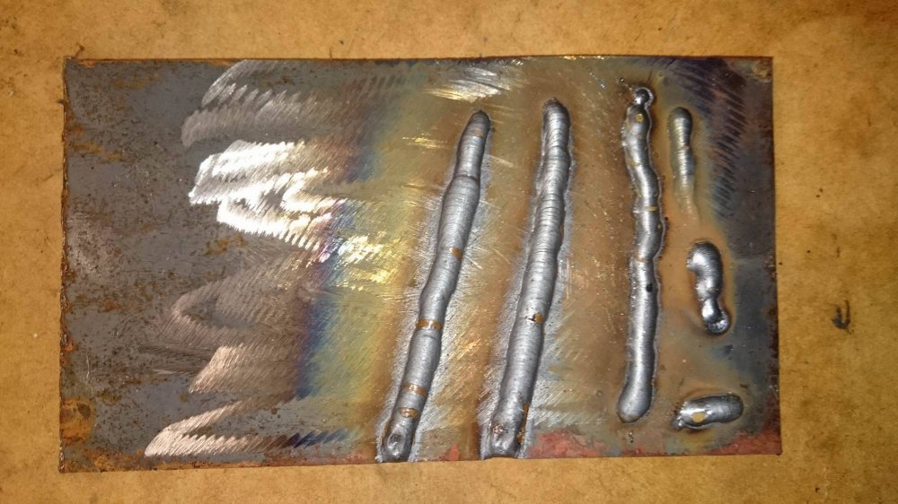

T TheRealTy New Member Messages 13 Location Brisbane, Australia Mar 14, 2016 #1 Hi Guys, These are my first welds, I have welded once before about 2 years ago (about 30cm bead). Happy for any criticism and feedback. My welder is a Unimig Viper 182 Inverter running .8 wire 12837557_10153419701658045_1006730203_o.jpg 118.2 KB · Views: 57

pedrobedro Man at Matalan Messages 13,086 Location CX near Chesterfield Mar 15, 2016 #4 Less feed speed and move a bit faster and more constant speed, you are putting too much down and it's sitting on top now wetting out. Get the tip close to the metal, watch the tutorials and some tube videos and keep at it.
