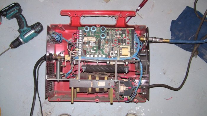

Hi all,

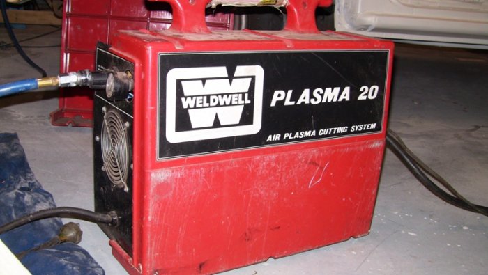

Well I have been given an old plasma cutter. I think it was the first one ever made, well from the era anyway, lol. Beggers can't be choosers, It was free.
It is an old "Weldwell" brand 20 plasma. Weldwell is a NZ company btw. I was told that it was repaired and when It left the shop it was apparently working. That was like 5 years ago, I picked it up out a trailer ready to go to the dump.

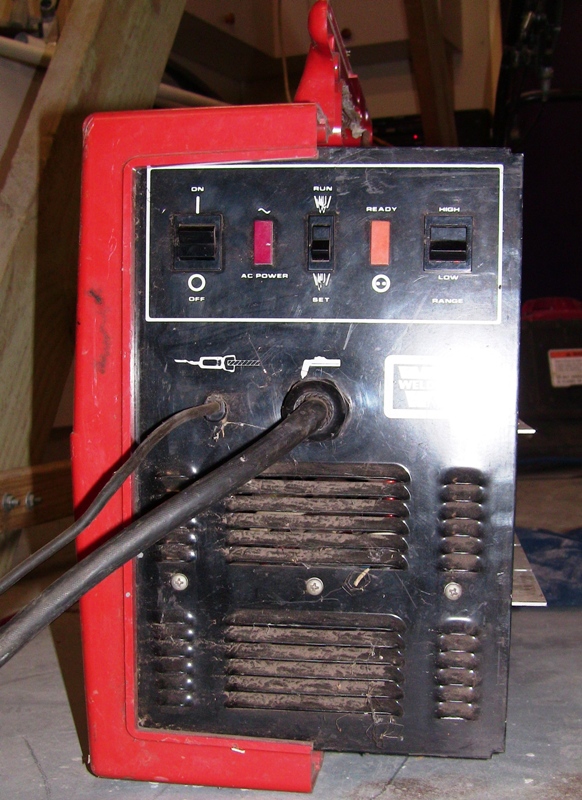

It will turn on, fan spins, there is a set/run switch. When on the set position, the air will flow out of the torch and you can adjust the pressure on the regulator on the back of the unit. If it goes below about 35psi (from memory) the orange "ready" light will turn off.
Well at least it turn on and the solenoid for the air works in set mode. Then you flick it up to run and try it and nothing happens.
I put in a new nozzle spring, nozzle and electrode today, but nothing.
How do you fault find these things, where do I start?

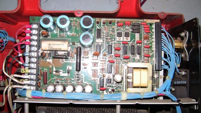

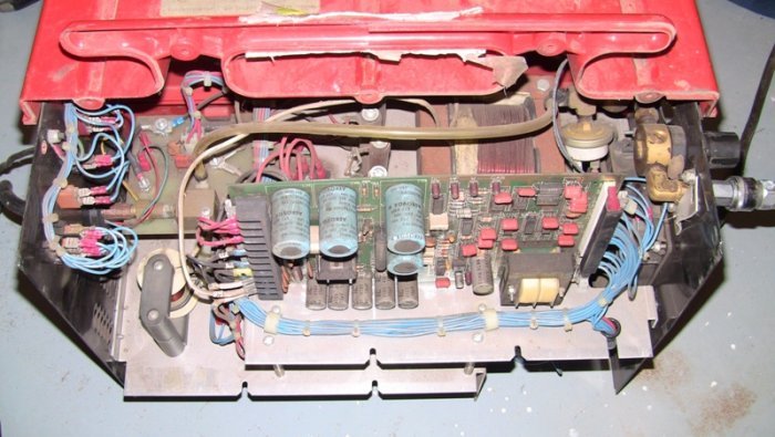

There are some LED's on the mobo inside. The "air" LED lights up and another one does too. But the high frequency "HF" and the "DC" do not. There might have been one or two more LED's.
Anyway It would be great to get it going........it's about 24 amps so that should cut 1/4" and that will be sweet.
