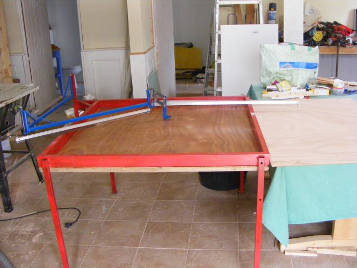

While lusting after a CNC machine for plasma cutting, the cost of a new one or the time and complexity of DIY, for the likely work made me think a fresh.

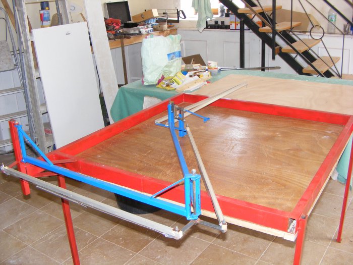

So, this is the result. The torch is fixed in the cradle at the end of the arm, which works like a drawing machine with parallel acting arms. The design is clipped to the table on the right and followed with the pointer at the end of the ally extension. Due to the action of the arm, the torch will cut exactly where the pointer moves on a 1:1 scale.
The table is a bit bigger than 1X1 mt, so will easily take a half sheet and is set up for water with a drain at the top right. Just need to make the support rails and get a new plasma. I managed to sell my pld 3-ph one and am now looking at single-phase ones and saving up
One of the problems with the arms is back-lash, not bad to the right and bottom, but might become a problem at the top left. If it does, I plan to replace the control arms with light chain and cogs. At the moment, there are springs under the arms to tension the joints so the slack is held one way. It is slight but if the torch catches on slag, it might be an issue.
Any comments?
