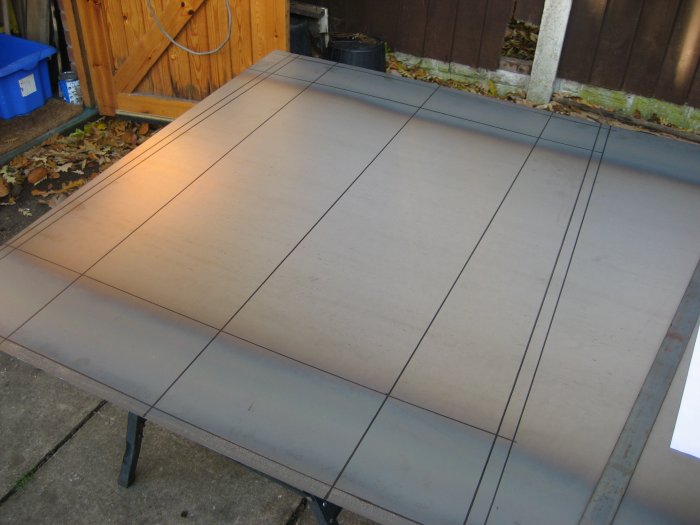

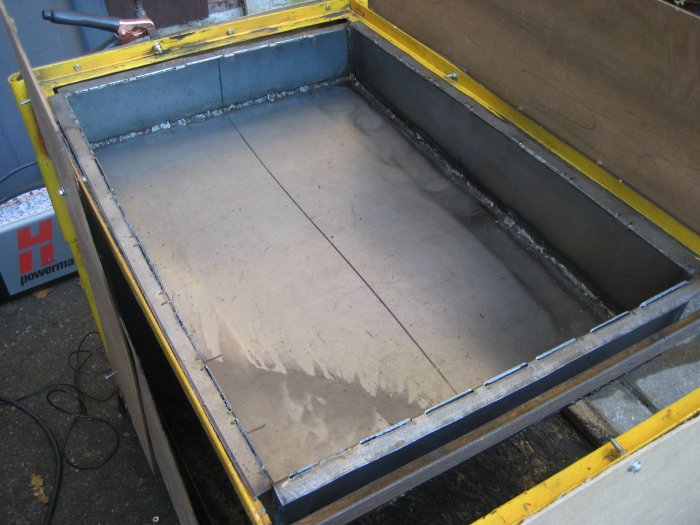

Having tried a small bowl of water under the table I decided to go the whole hog and build a full size 'water tank' to absorb the sparks and dust from below the cut steel and I'm putting an extractor fan on the 'top' side too.

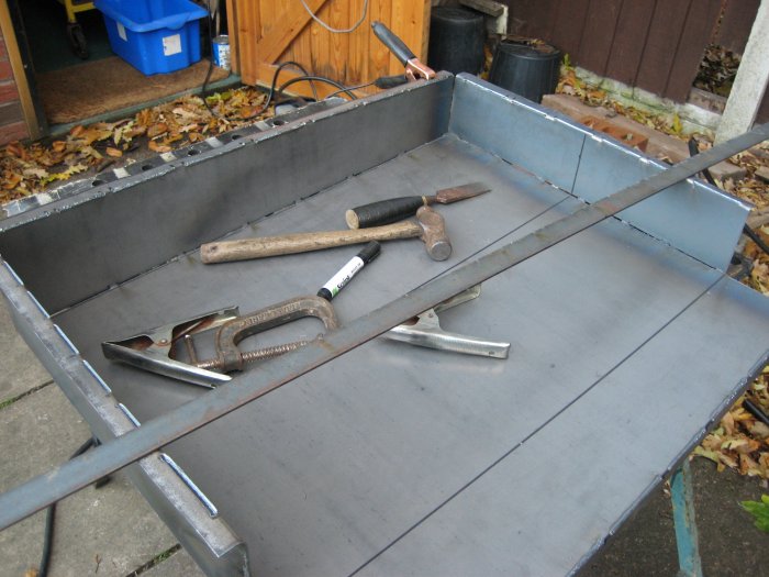

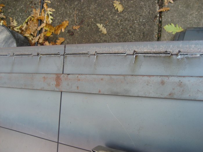

Having just sold my metal folder - silly me - I had to perforate the 1.5mm steel with the plasma and bend it up by hand before welding it all back together. It will hold about 60 litres of water so quite heavy when filled.
Had lots of pin holes so have spent a long time going over the welds to make it watertight. Will fit the drain and give it a coat of paint next. Pics of finished unit to follow...and hopefully a clean workshop!!
