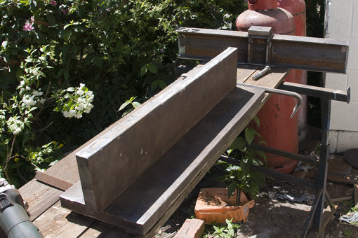

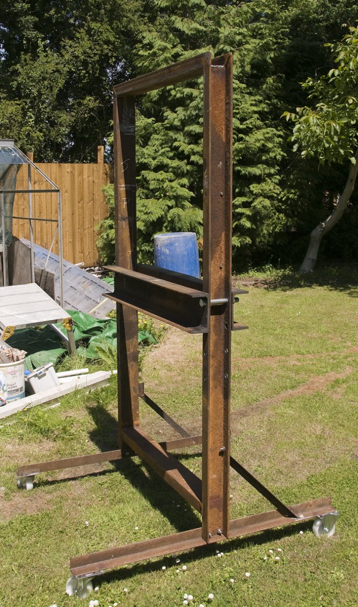

Planning a "press" bender, usual DIY H frame arrangement with hydraulic power/jack

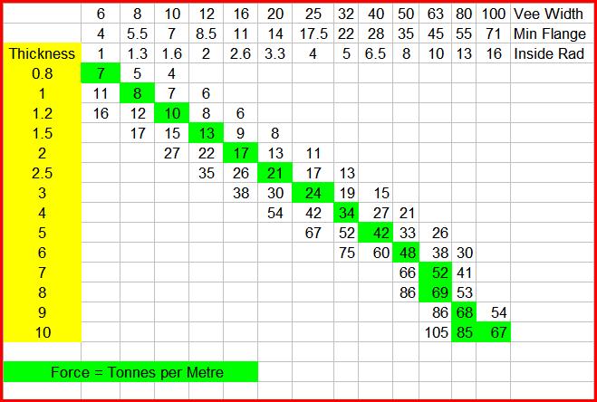

Would like to bend up to 900 wide and 3mm thick stainless, usually only 16-18g & narrower & MS, occasionally much heavier MS... 10x70-10x100 ( optional at this end I can always get them done, but waiting is getting to be a pain in the ass)
what kind of tonnage do I need to form bends?
We can worry about structural strenght later it will be plenty strong
probably try to add guilotine & punch press too, if your going to do it might as well make it as hard as possible ( & mind your comments Sparkley)
