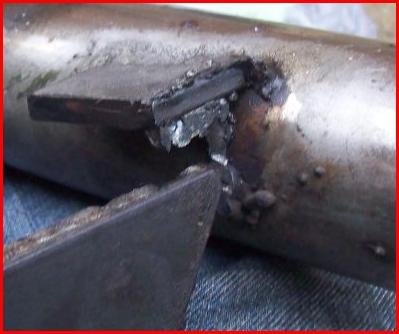

hi, i have a jap import mr2 turbo. which is quite highly modified.
it came with a very rare apexi IHI turbo kit and manifold. but this manifold has been cracking on me since day one. it seems it was poorly repaired in japan by its previous owner. i have since removed it and given it to a local mate to repair it on 2 occasions. but its still cracking. and his opinion is its come to the end of its life. as his good welds are just cracking weaker welds on the system. he basically suggest that i should get one made up from scratch.
here are his comments
From our joint knowledge we reckon the main 4 runners on the mani are 321 stainless, the vertical pipe is 304 and the flanges are something even we cant identify! Welds like Mild Steel Boilerplate but is non-magnetic so therefore non-ferrous (i.e. stainless)
It has cracked on the flange again because it is a mis-match of materials and incorrect manufacturing & welding procedures (should be swaged then welded). I am telling you now it will crack again and Tom (welder) does not want to be "owning this problem", which i have to agree with.
In my honest opinion, get it remade have it fabricated WELL from a good 304 stainless steel throughout. OR from 321 Stainless throughout. you will see a much better product from somthing made of matched product than mis-matched - like we have here.
i just wondered the sort of costs involved in getting a new thicker material manifold made up. with a few braces to help prevent cracking????
where and who could possibly do this in the kent area??? and sort of prices???
these pics are after the first repair, but it has since cracked mainly around the flange with the 4 running join.
