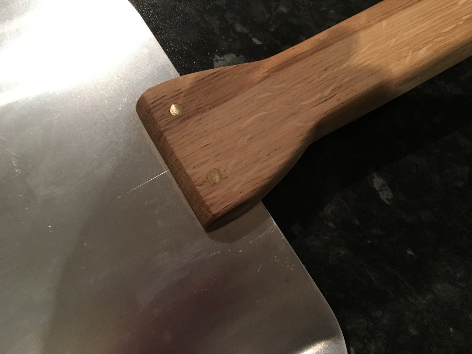

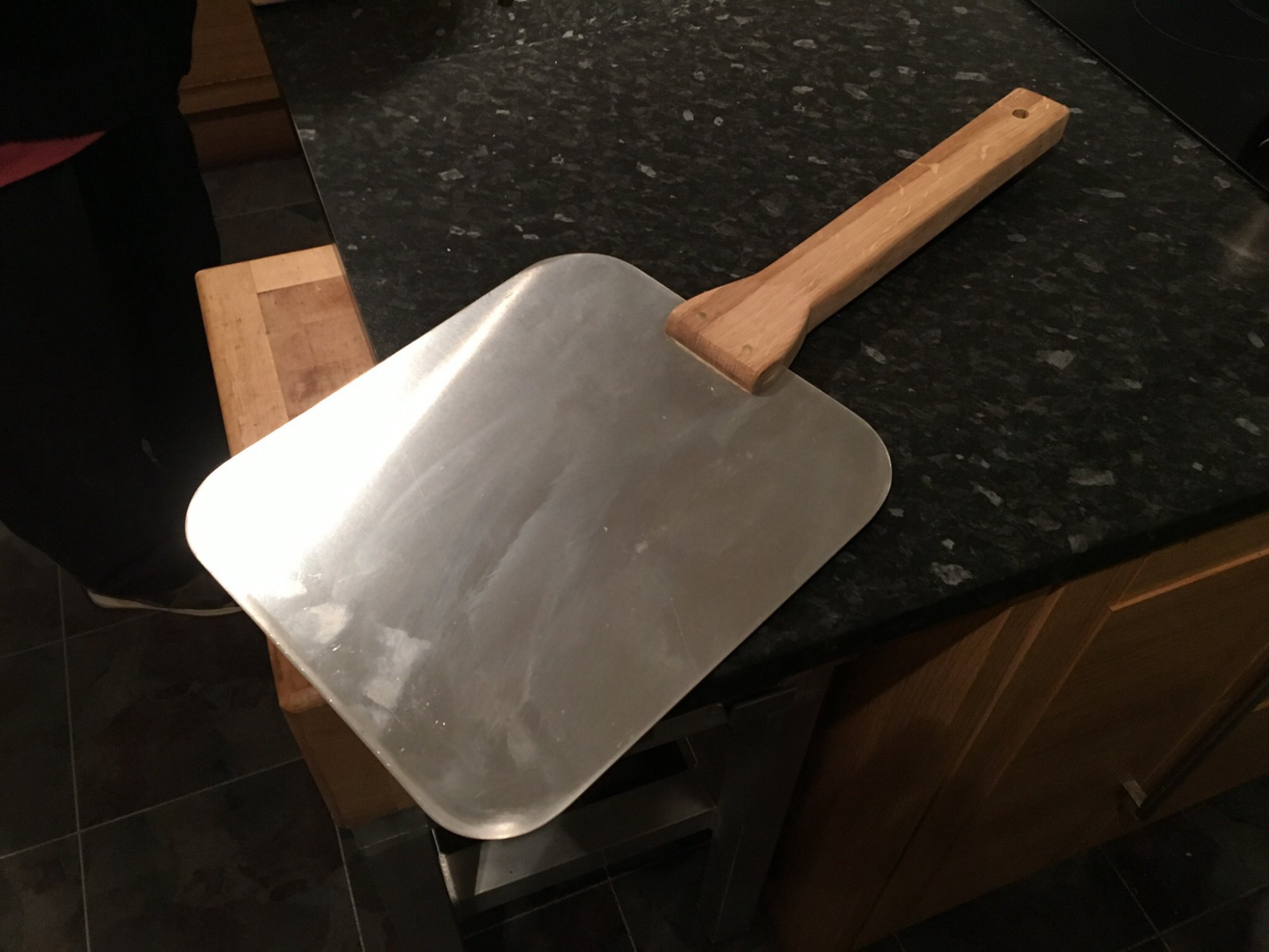

i was all kitted out to have some workshop time this evening but then didn't have a blue plug to get the plasma working. So instead I made a Pizza Peel.
I have a 5mm steel plate exact size of an oven shelf, much much better than a stone. Needed a peel for it so knocked this up. 1.5 mm aluminium sheet, solid oak handle, two brass machine screws used as rivets peened over into slightly counter sunk holes
