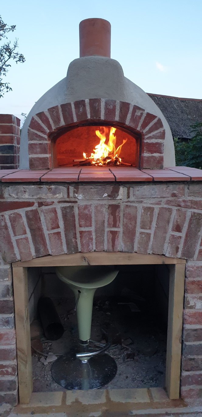

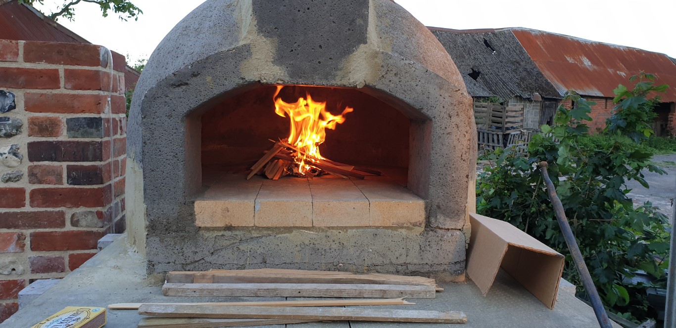

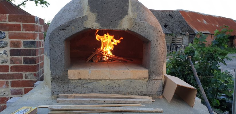

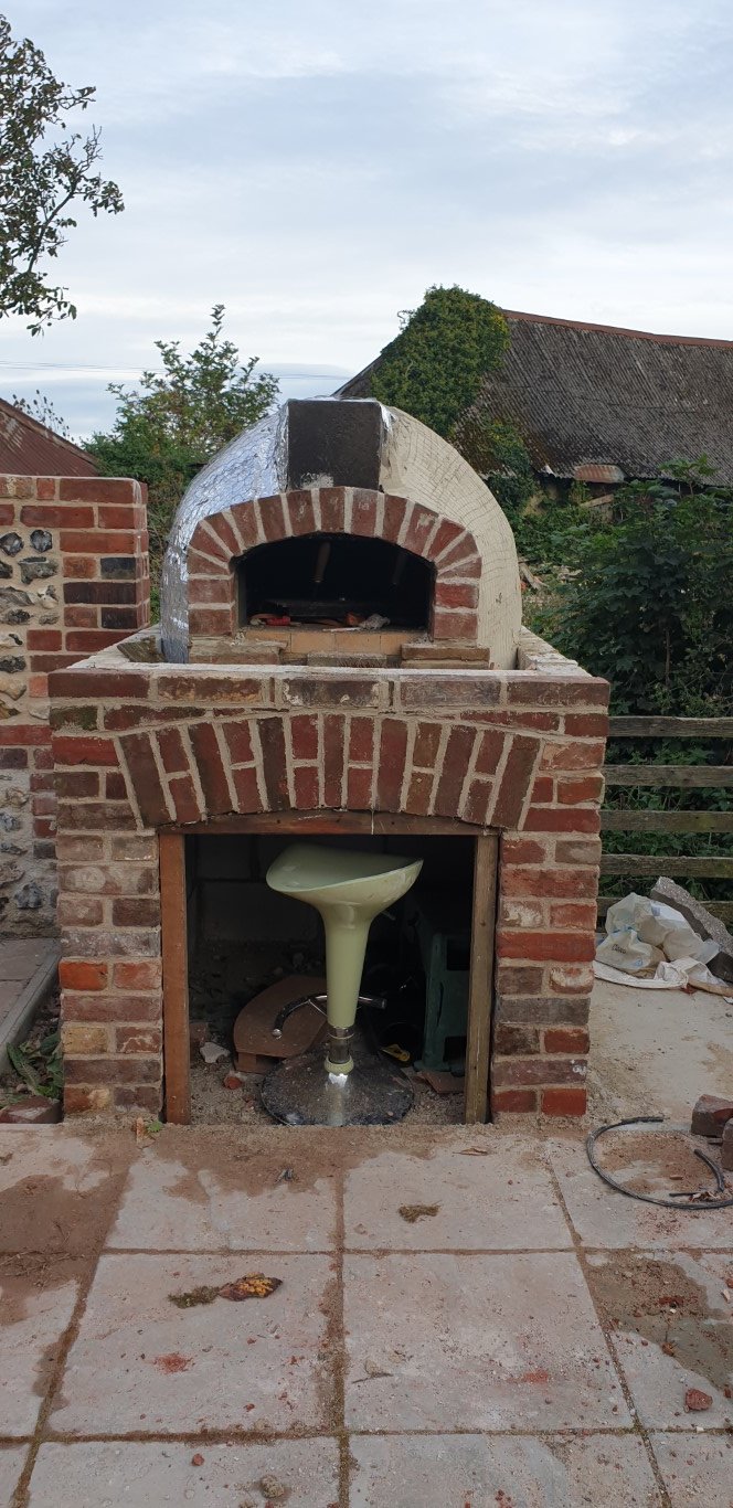

View attachment 194534 Your fire looks like a demon on fire!![]()
Lol, see where you're going with that one

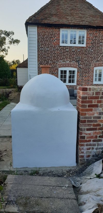

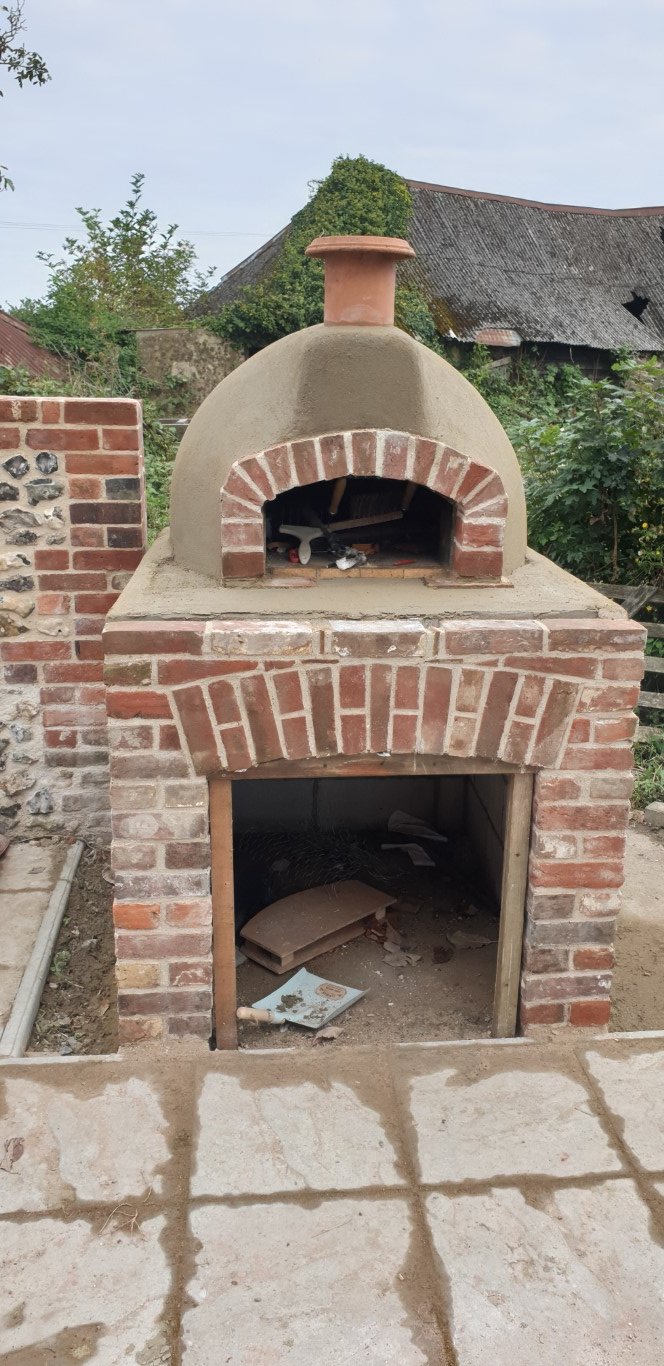

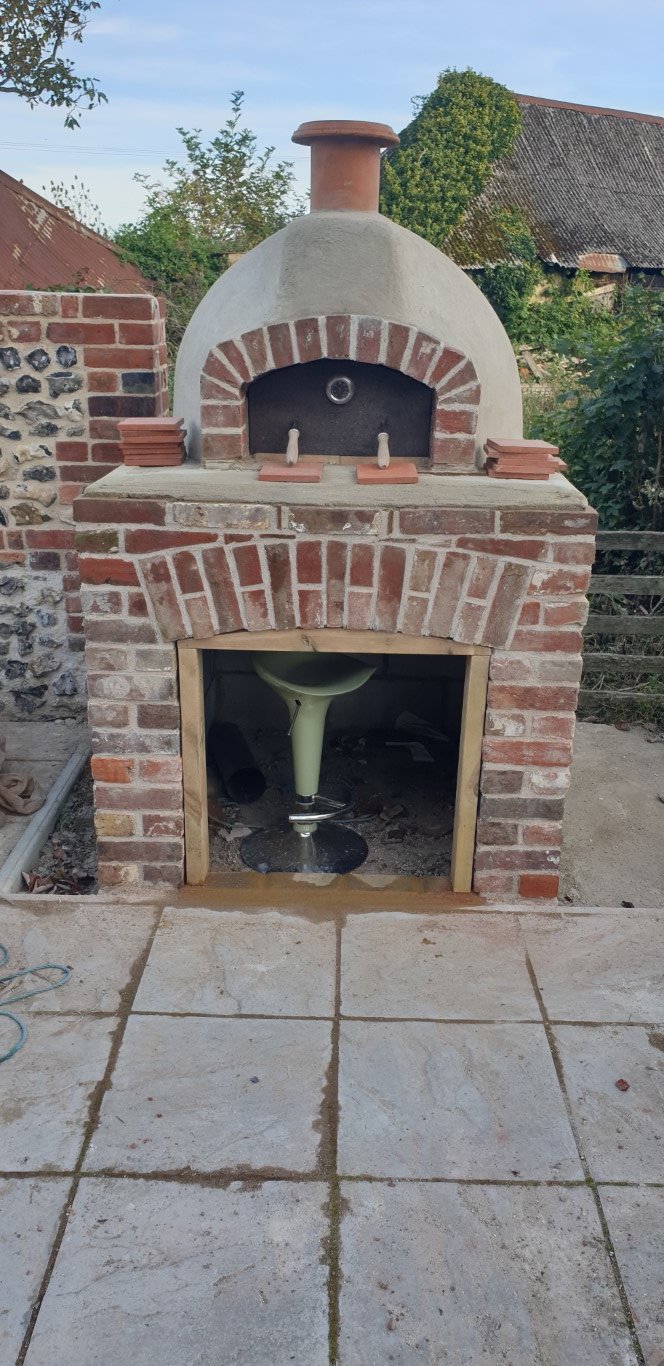

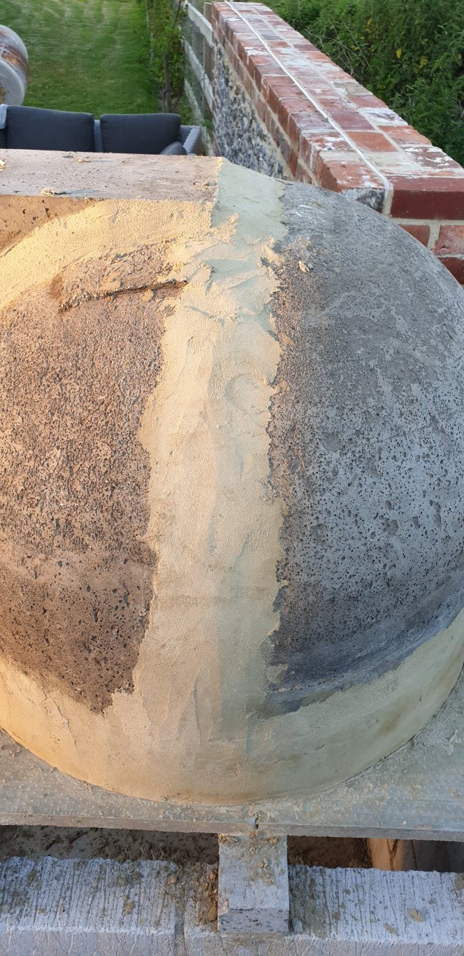

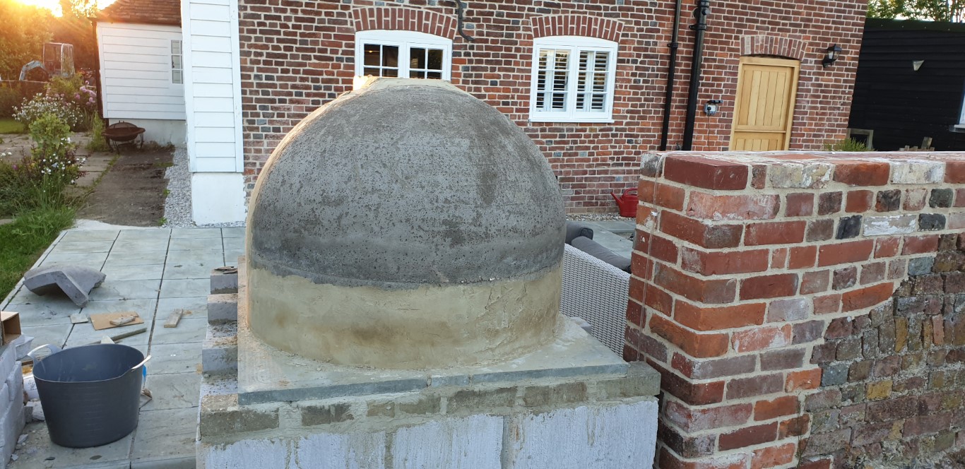

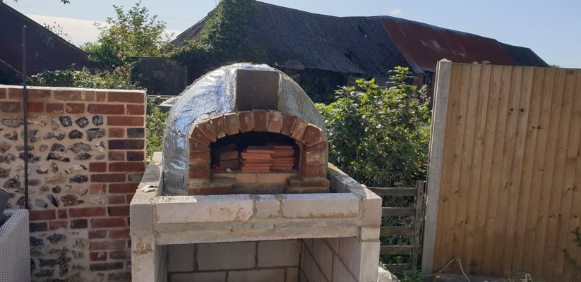

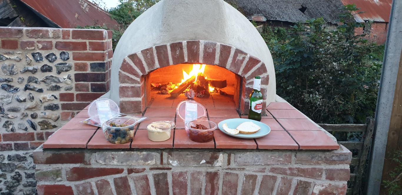

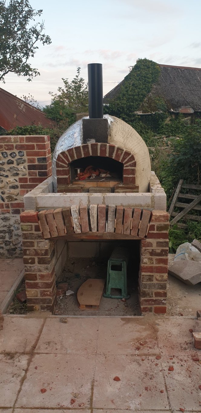

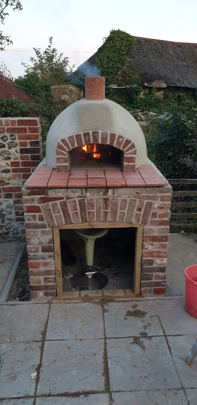

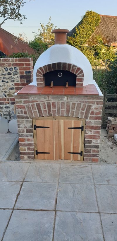

So managed to finish this off last weekend and just made our second batch of Pizza yesterday

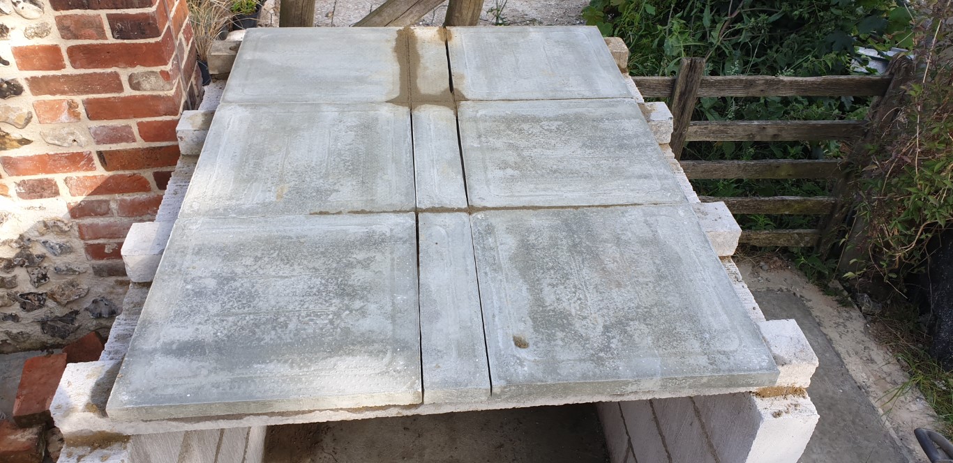

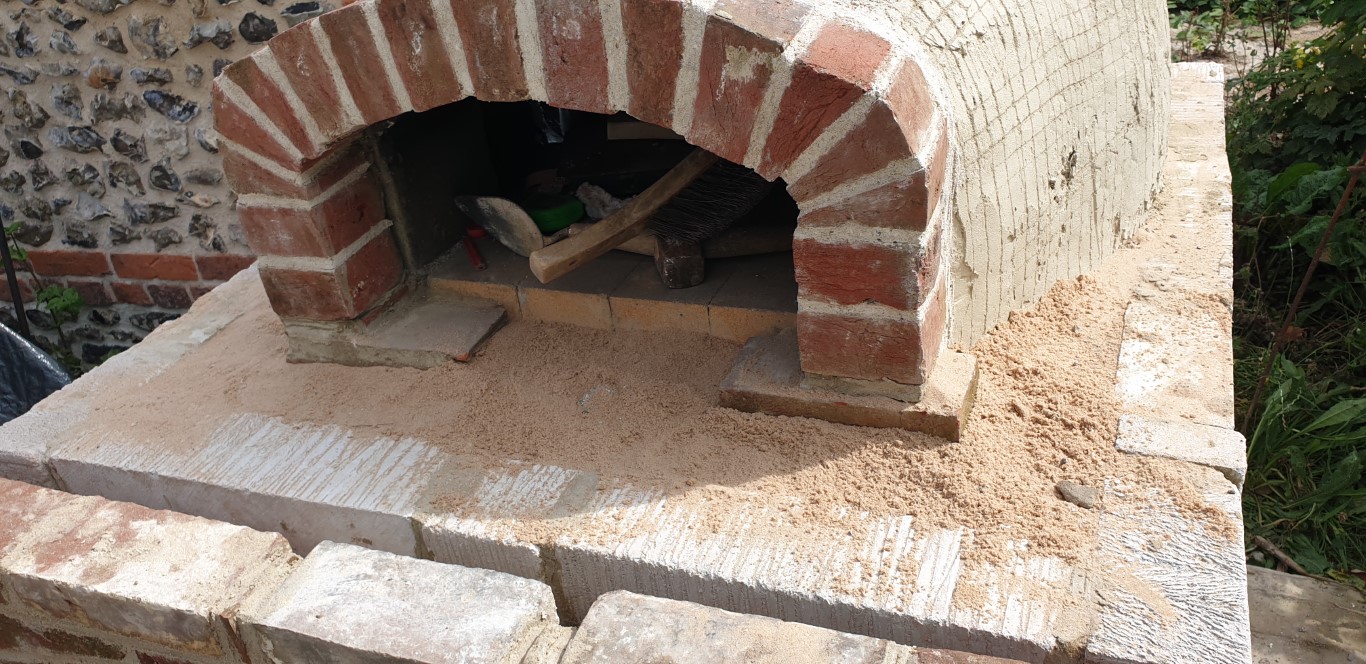

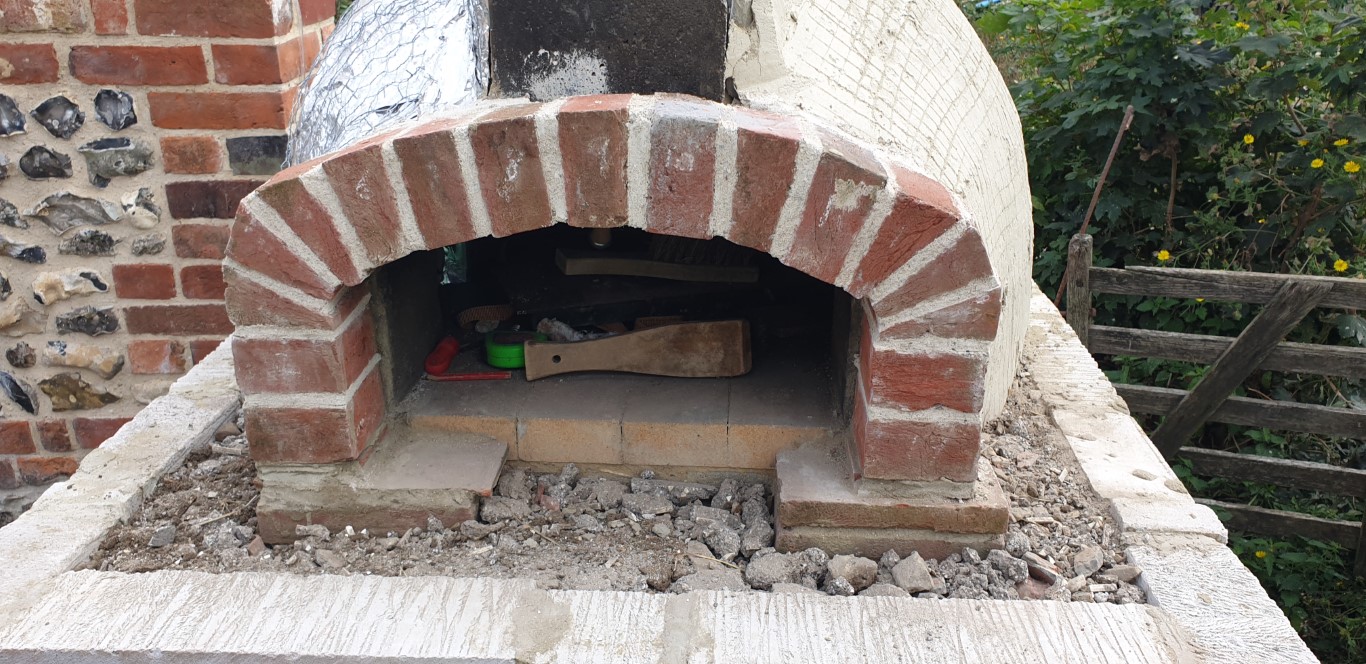

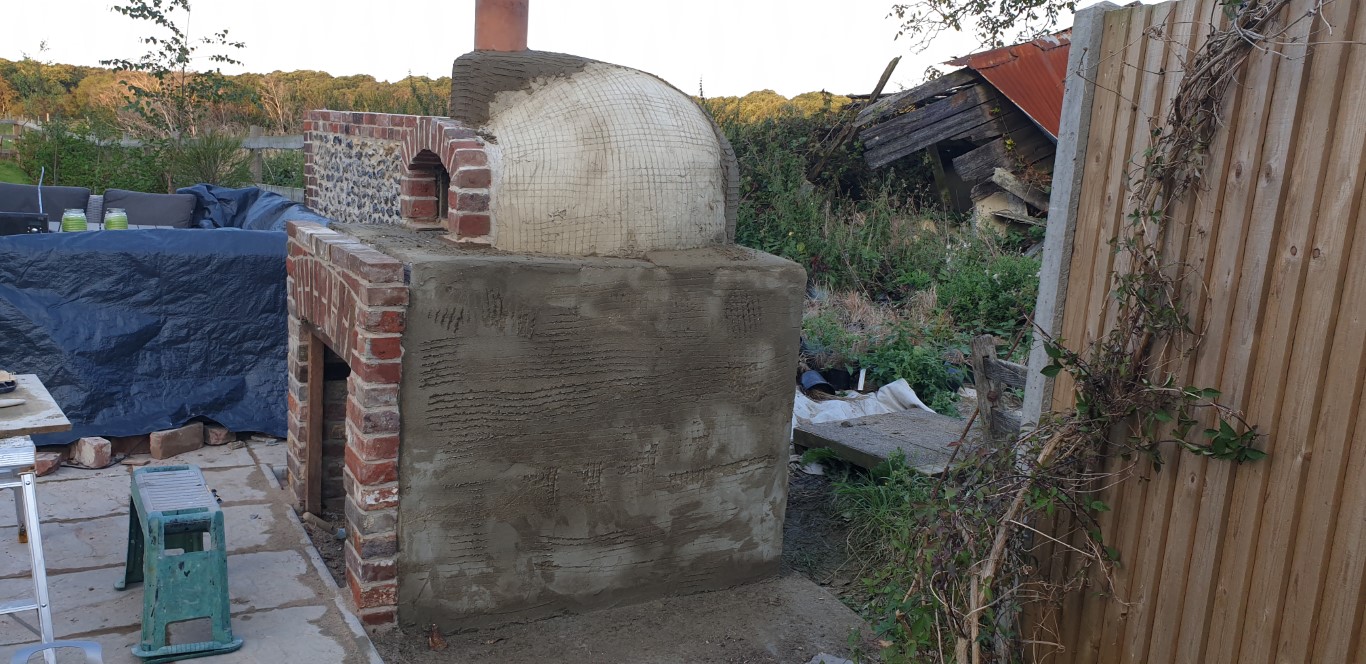

First job was, having laid the tiles, I then needed to grout them in and build up the rendering around so that they were flush with the edges etc. Also applied some sealant to the tiles but not sure how well this will weather over the winter.

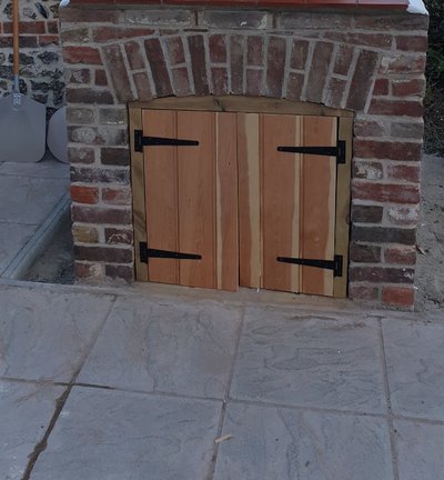

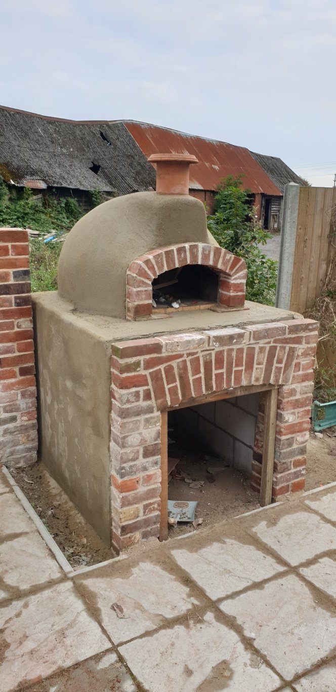

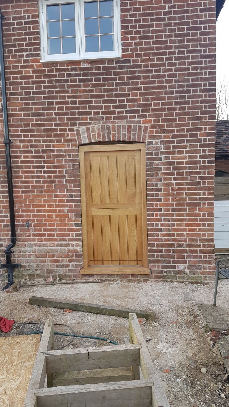

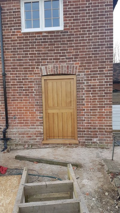

Then made some doors for the wood store underneath. Local timber merchant only had 1 length of bead and butt left which was as twisted as a barley sugar
- hoped I would get away with it but it isn't ideal

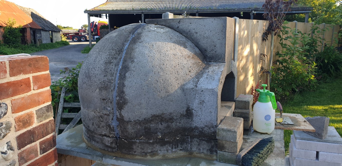

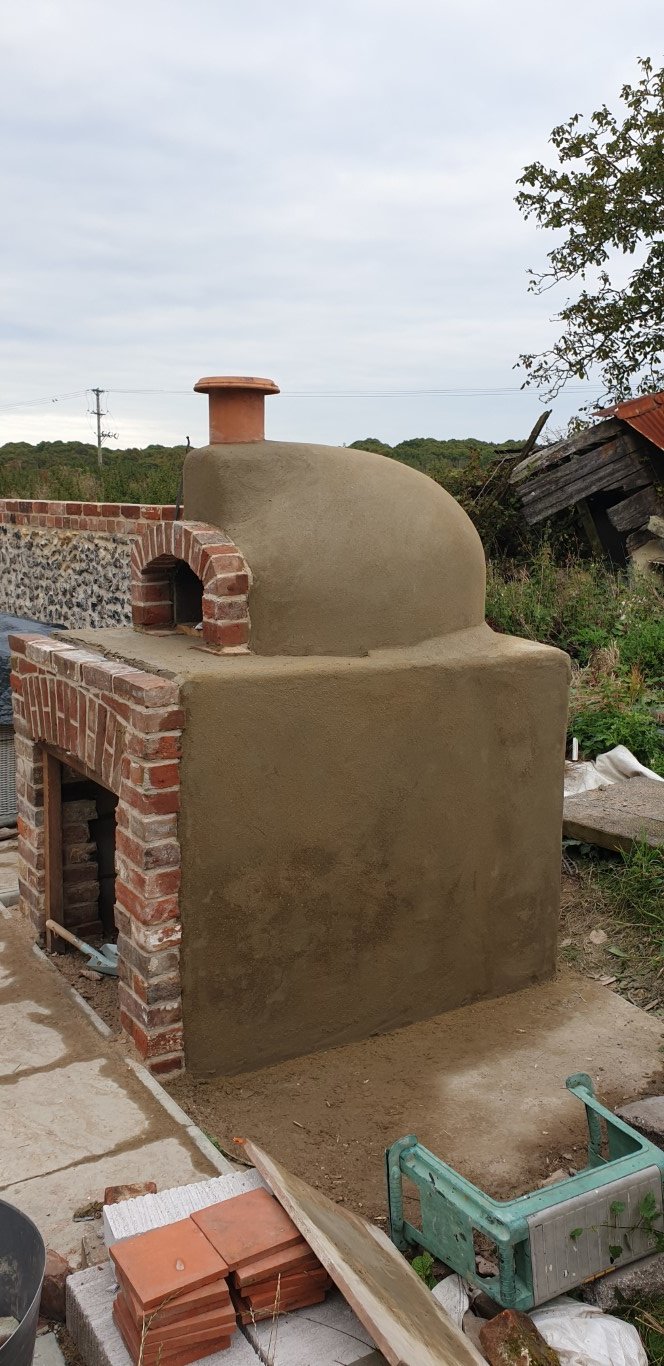

Then finished off the whole oven with 2 coats of Sandtex to hopefully keep most of the moisture from being absorbed into the render and here is the finished article.
Have to say it looks really good and very pleased with it - but boy did it take some effort
