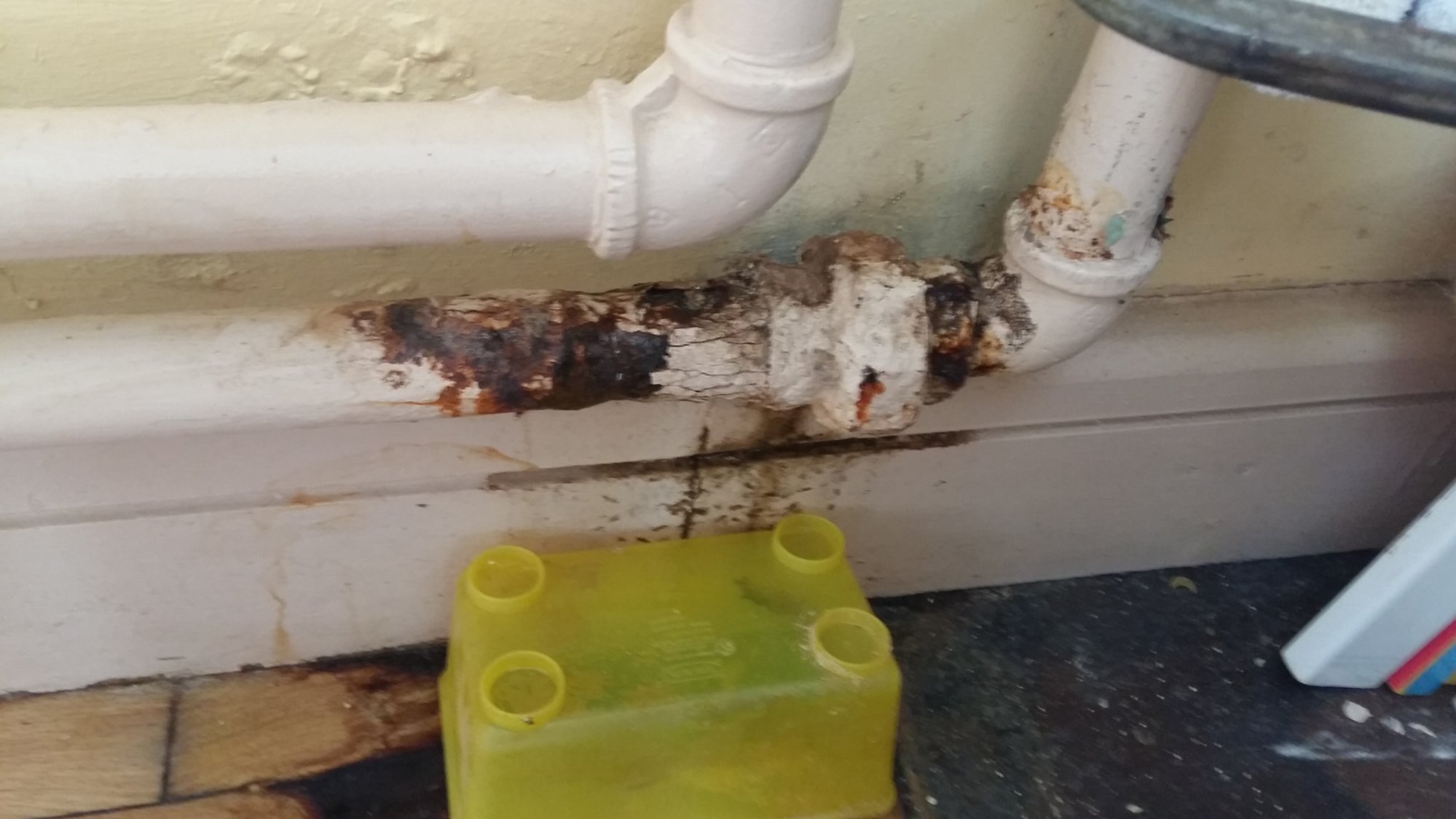

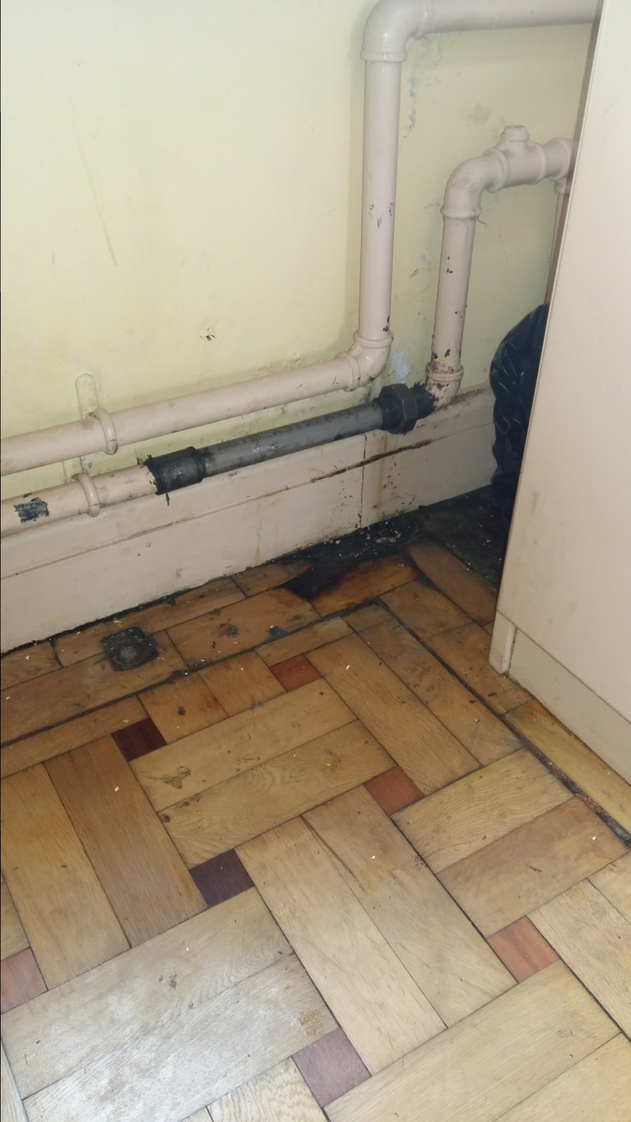

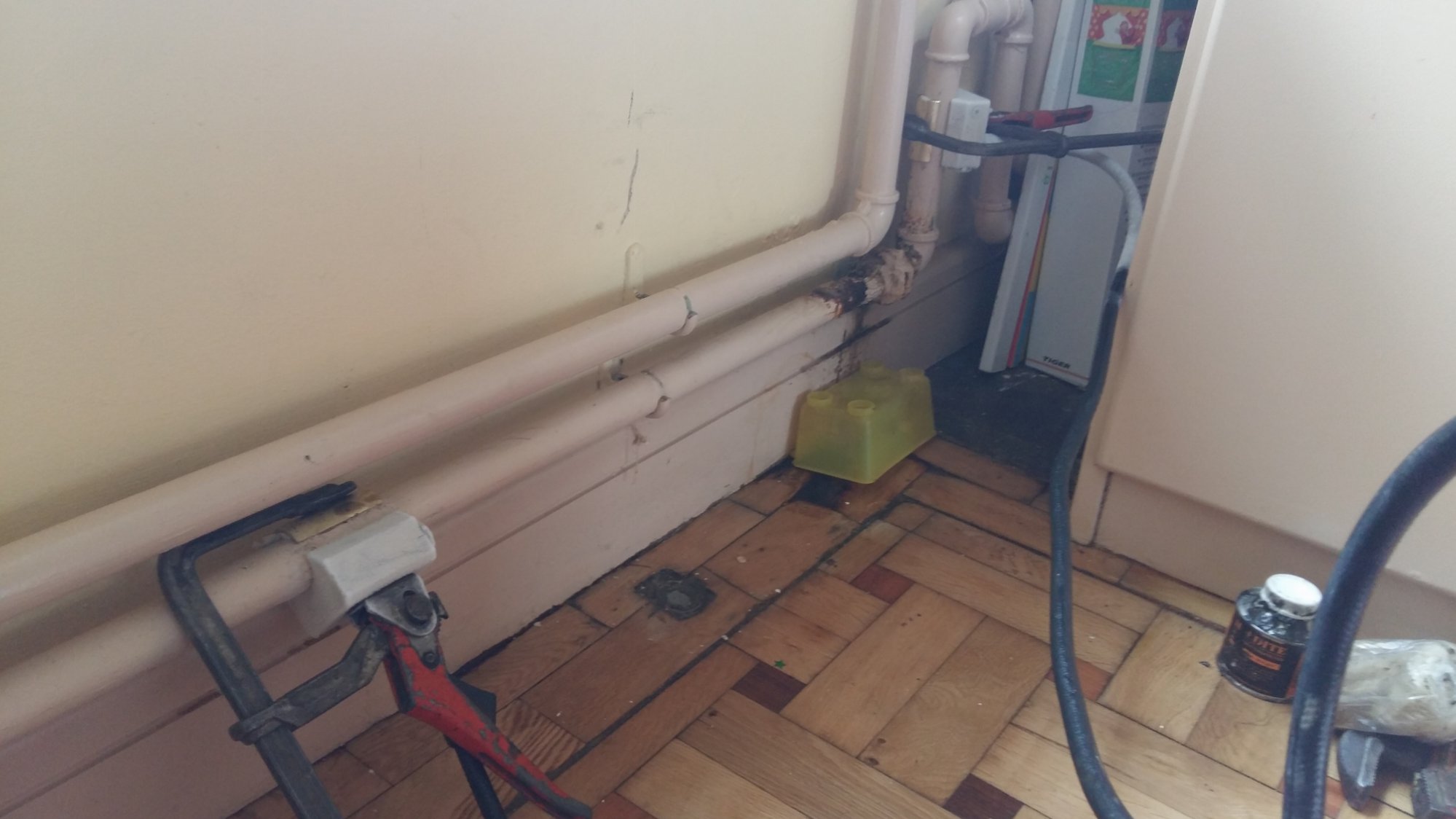

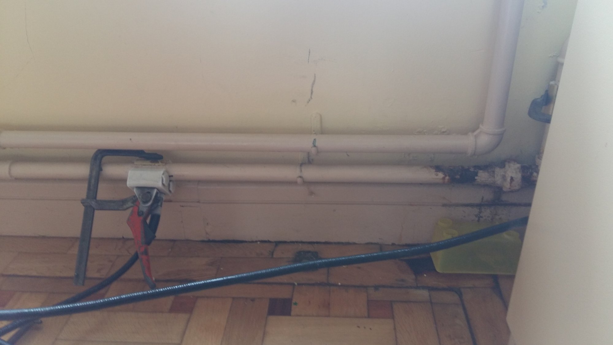

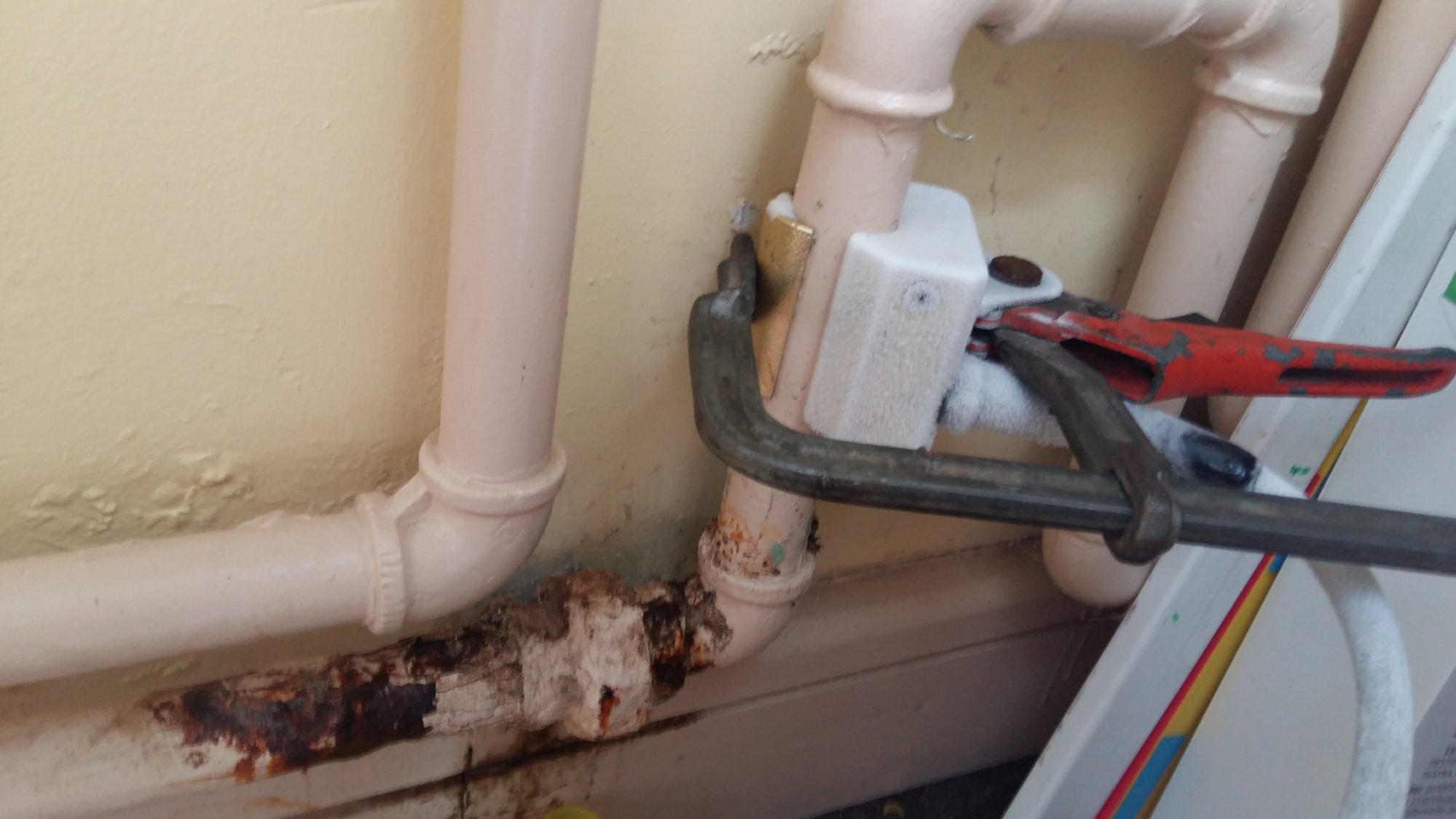

A few shots from Saturday. A pipe that was leaking bad and had to be replaced in a school. 3 plumbers refused to do it and one of them rang me last week to see if I would manage it. The cause was that a big of salt was left in that corner for ages. Bleeding the pipes was not am option for me because I don't know enough about it and would have been a big hassle so I decided to hire a pipe freezer. Left it on for about 2 hours and it did a great job. Replaced pipe and no leaks. Happy out with myself. ☺
