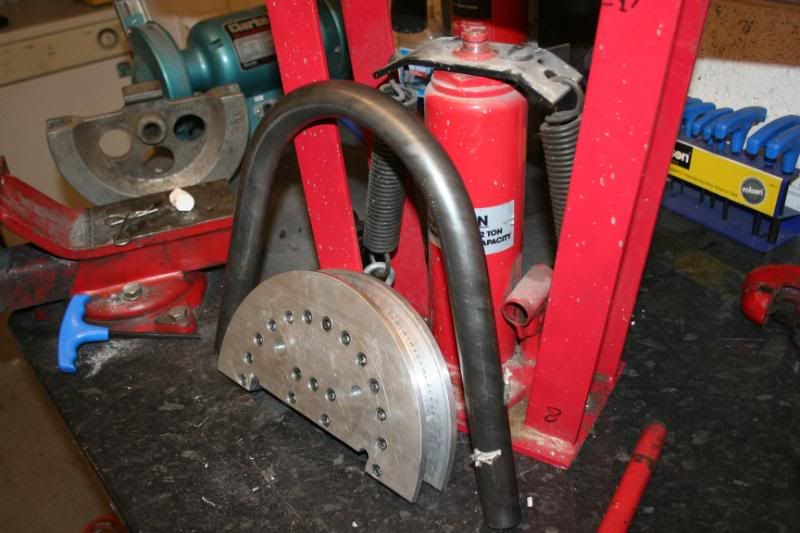

If you click on the picture it takes you into my photobucket thing, there is a series of pictures of it being made, a combination of lathe and millThats a nice bit of work. Did you make on a mill? does it split into two halves?
Just such an item is in the sales section should you still need one?Would a Clarke type 12 ton pipe bender manage 3mm wall 48mm pipe or is it called tube or even round hollow section?thanks
My dad tried to bend some scaffold pole...ish size pipe for a large frame he was wanting to build. He wasnt having any success and kept creasing and flattening it, I told him to fill it with sand. We went and got some fine, dry sand from a dune at the beach, filled the pipe, bunged the end and the job was a good 'un.
It bent well to 90 degrees, 4 bends to form a large rectangle and then we just tipped the sand out.
We put a wooden bung in an end, i climbed up on the shed roof with a piece of rolled up cardboard and a bucket of dry, fine sand from a sand dune, the pipe end was passed up and i poured the sand down the pipe til there was just enough gap left to hammer a bung in the end. It was a long length of pipe, the rectangle we made was about 11' x 6', we made 2 of them. We used a Clarke pipe bender. The results were the same as a manufactured bend on a frame he was trying to replicate. Once the pipe was bent the bungs were removed and we just repeatedly turned the frame letting the sand pour out. The trick was it had to be fine, dry sand or it wouldnt have poured in and back out, and getting the end of the pipe nice and high to pour the sand in, we tried at a shallower angle but with no success.Hi ,
