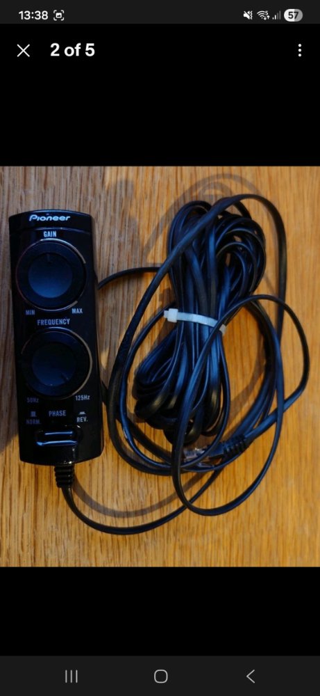

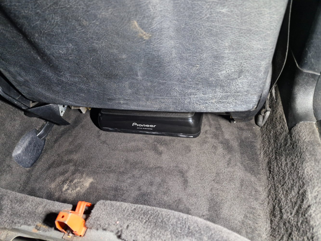

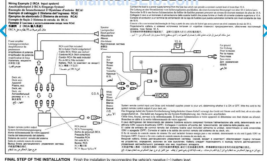

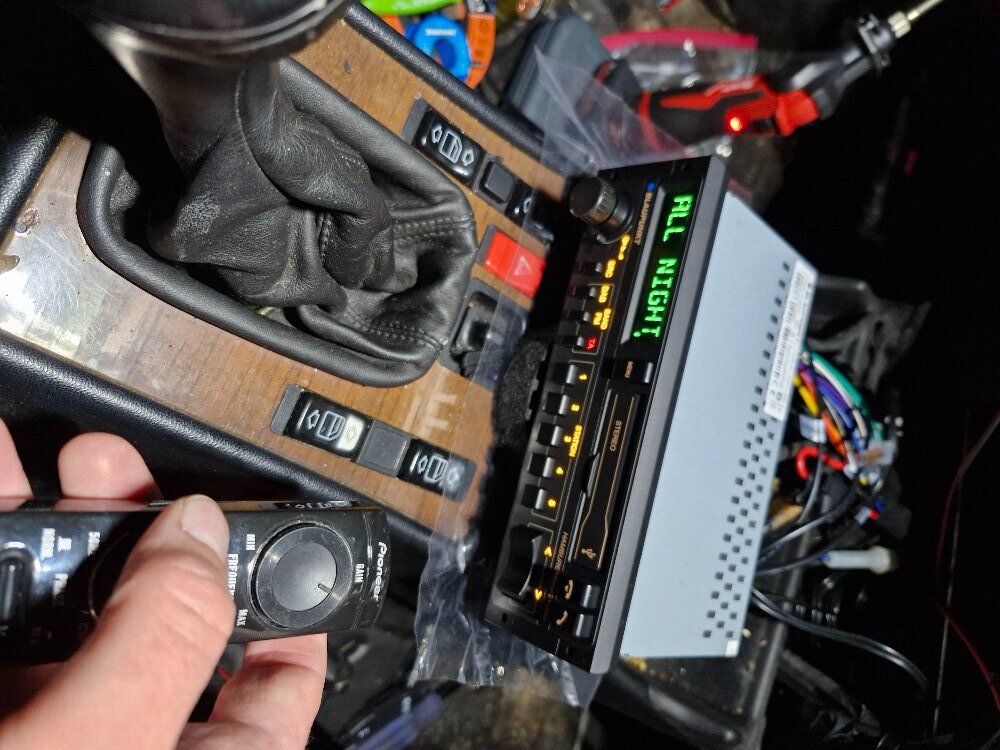

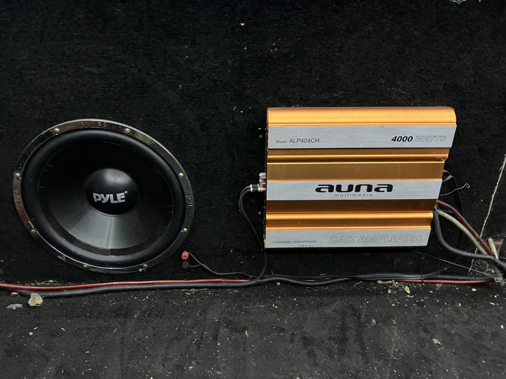

I just ordered a good used Pioneer active sub woofer from ebay. The online PDF wiring diagram is a bit vague

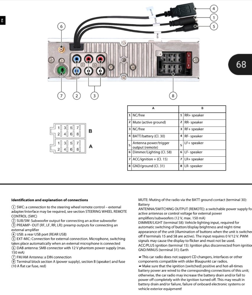

My new Blaupunkt radio has sub woofer RCA outputs so ill use those. I would not want any part of the sub woofer to have permanent battery power. For safety and parasitic draws.
The 10amp connection I can put to an ignition on accessory feed.
Then the other smaller 0.5 sub cable must be a "signal" to turn it on and off? For that I can tap into the new radio's power antenna output which will be good as that means the sub should come on and off with the radio automatically.
I will test the sub woofer wiring when it arrives to confrim the above functionality. Does this sound reasonable? Its for a 1989 Merc FWIW
