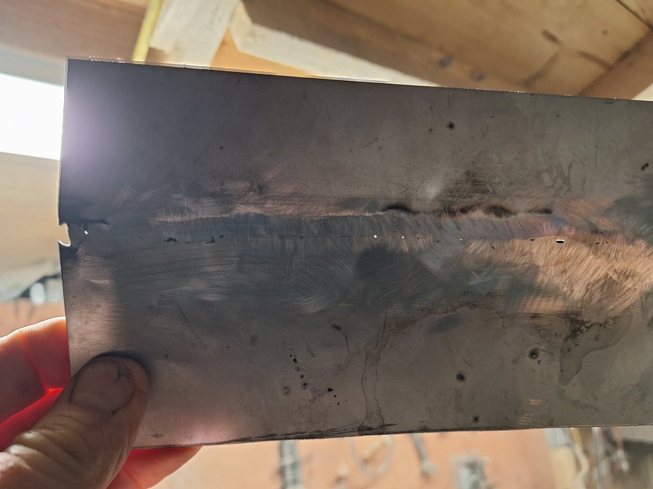

Yes, just pulse a spot into the hole, then grind back.Still in practice but getting better. After grinding down welds got few pin holes. (Scrap material so not important)
Could you just redo the pin hole areas then re grinding it.
