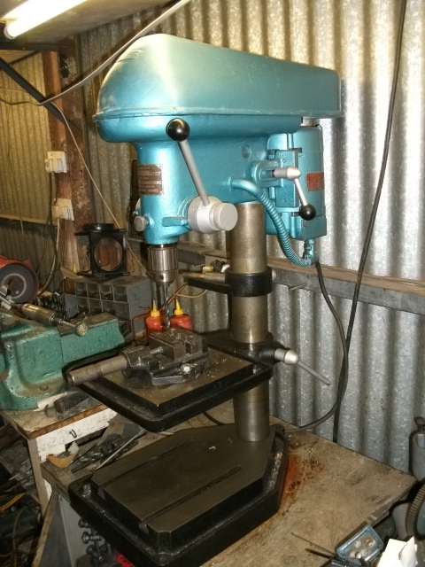

anyone purchased or built something similar?
where could i order these pulleys?
https://www.roguefab.com/drillpressreduction.php
I realize this discussion is getting into more than just this speed reducer... but-
You can run a 1 inch drill in an MT2 chuck. I've personally done it. It works fine. You can also run 100mm hole saws. I have customers running 150mm hole saws in thin stainless sheet.
We can ship you the whole kit from our shop in the US. Add $55 for shipping. All tax and duty paid by us. Delivery in about a week via USPS.
