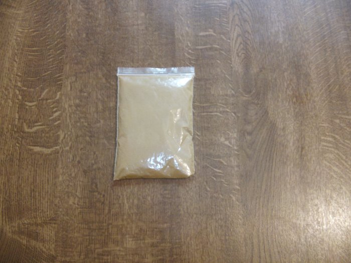

Has anyone used concrete colouring/pigment when making concrete? I obtained a small sample of pigment, as it’s called, to experiment with. I thought I may need to make a few blocks if I don’t have enough stones for the wall job that I am contemplating.
The pigment sample in the photo weighs just 100g, and is enough apparently for 10kg of cement (the ratio of pigment to cement for this particular colour is 1% pigment, and up to 3% for some of the other colours on the chart).
On a concrete mix of 321 where 1 portion is the cement, it is a tiny ratio of pigment. I have clarified it with the manufacturer to be sure, and they have confirmed that it is indeed 1 to 100 of the cement quantity not the quantity of concrete. I’m amazed, and it will be interesting to see how a test batch turns out in respect of the actual colour, which in this case is “buff stone”
Anyone else played around with this sort of thing?
