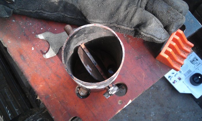

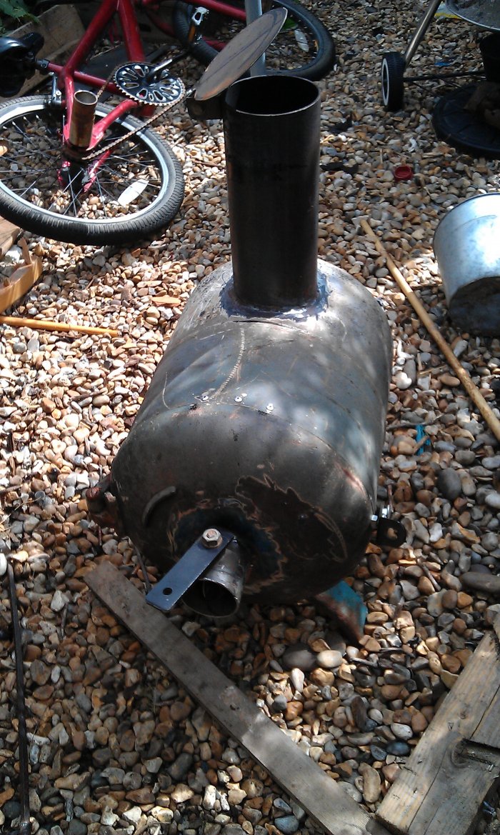

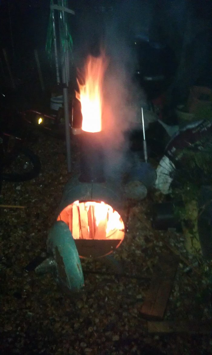

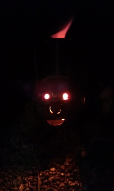

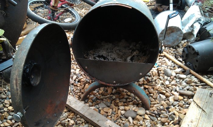

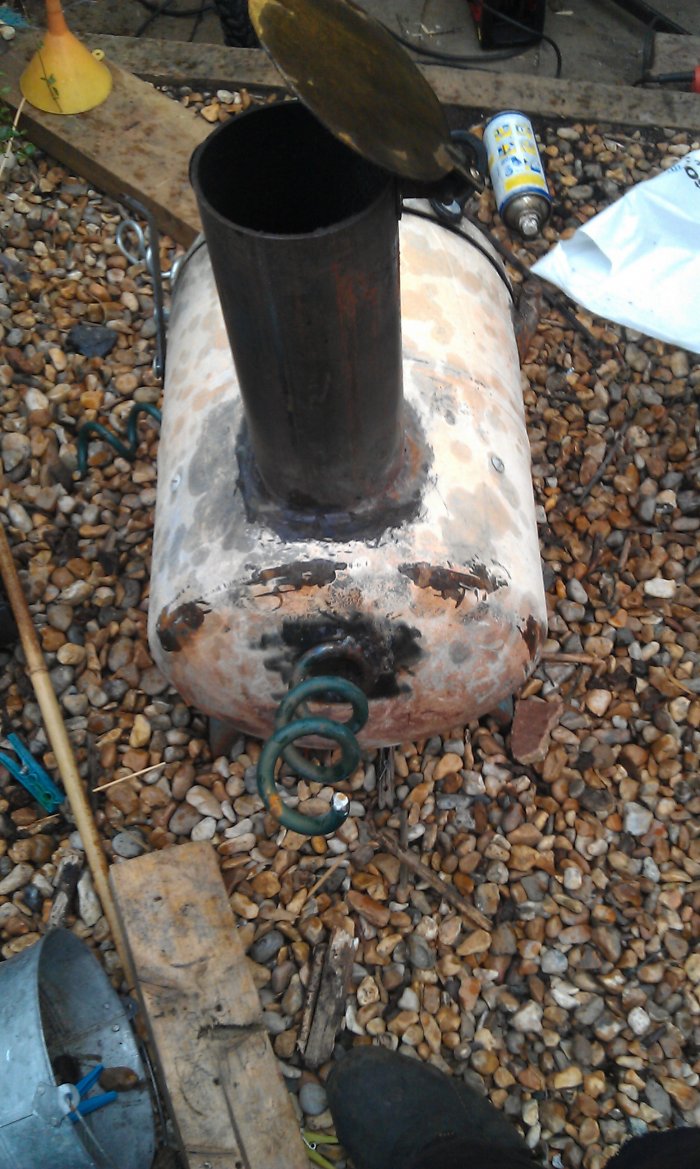

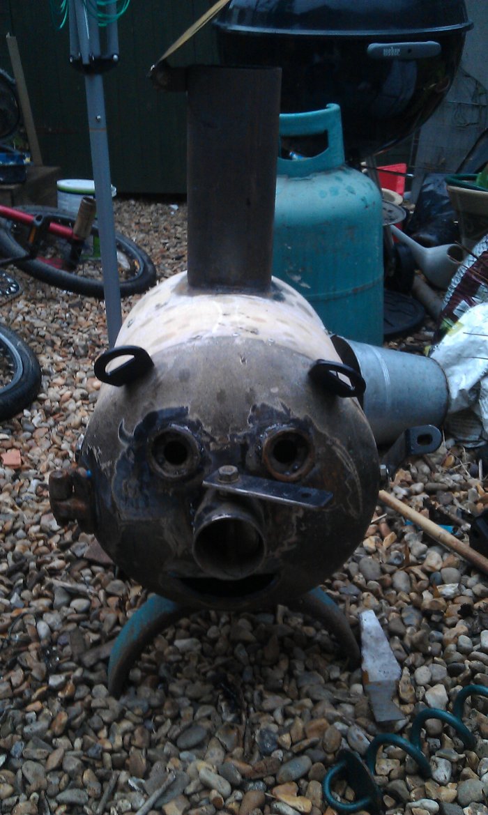

I have really enjoyed building my first woodburner. It has come out almost as hoped. Too much heat is going up the chimney so I need to add some sort of baffle under the chimney and extending forwards

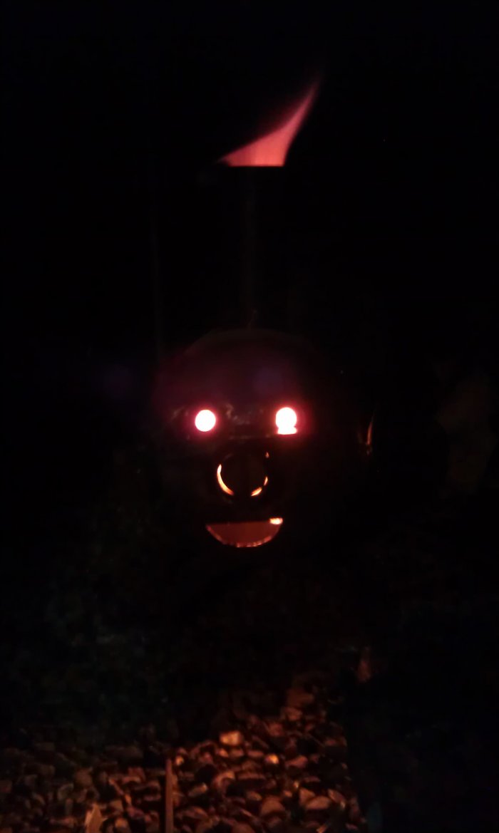

The air intake is a bit restrictive. Fully closed the fire goes out and it is very sensitive to position. I will cut some extra holes in the front in the shape of eyes and a mouth.

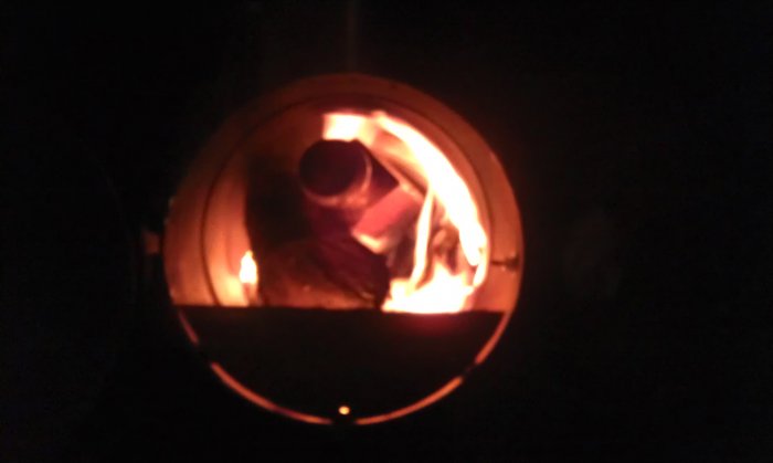

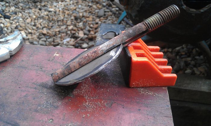

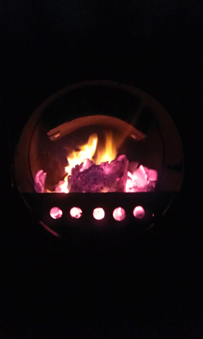

Possibly the semi circular plate in the front needs some holes in it.
