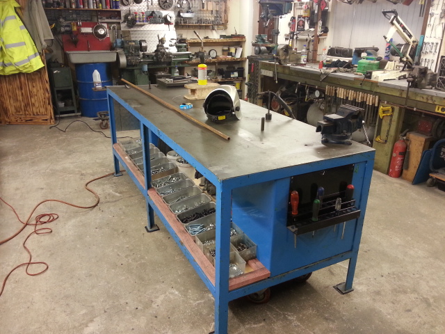

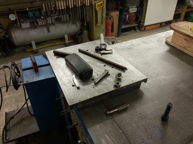

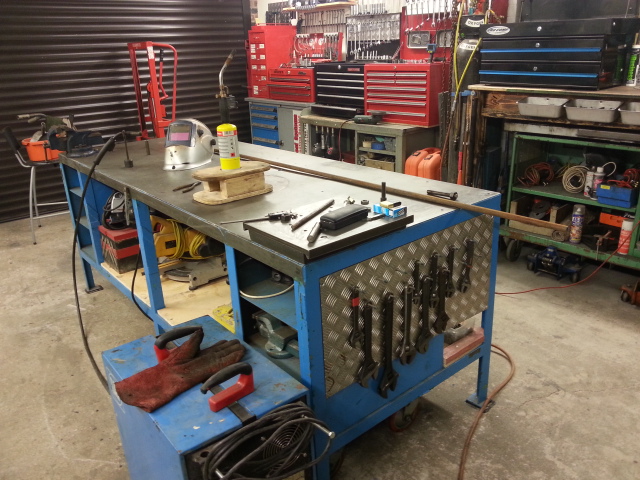

Recently bought this baby off Mickey D (cheers mate). Ideal welding bench plus ive bolted down an old little surface plate on the corner which i drilled and tapped a load of M8 holes into it for clamping down awkard stuff and also doubles as a anvil

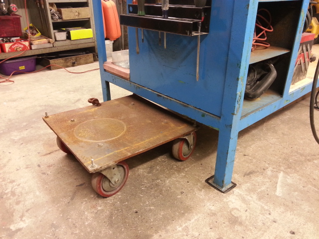

being right over a corner leg for light hammer work. Got all my consumable nuts and bolts off the shelves too as a bonus. Made the trolleys a while ago for moving cars around and these are great either end for moving the whole bench around the workshop should i need to for more room.Very happy with the purchase
