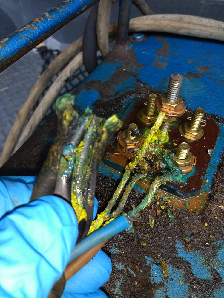

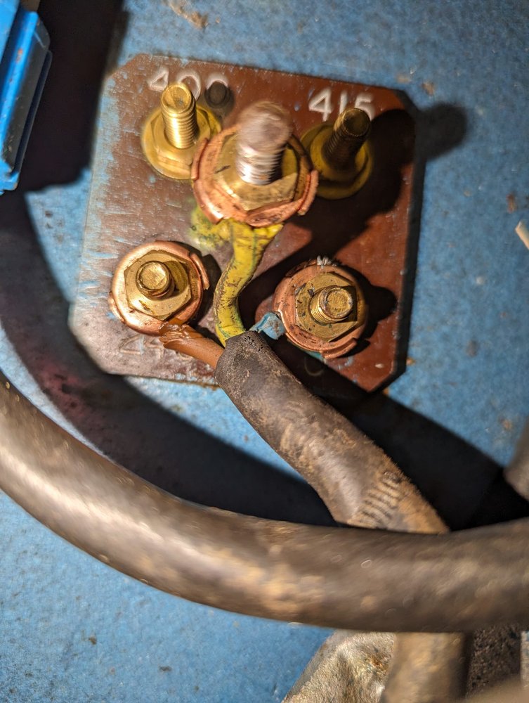

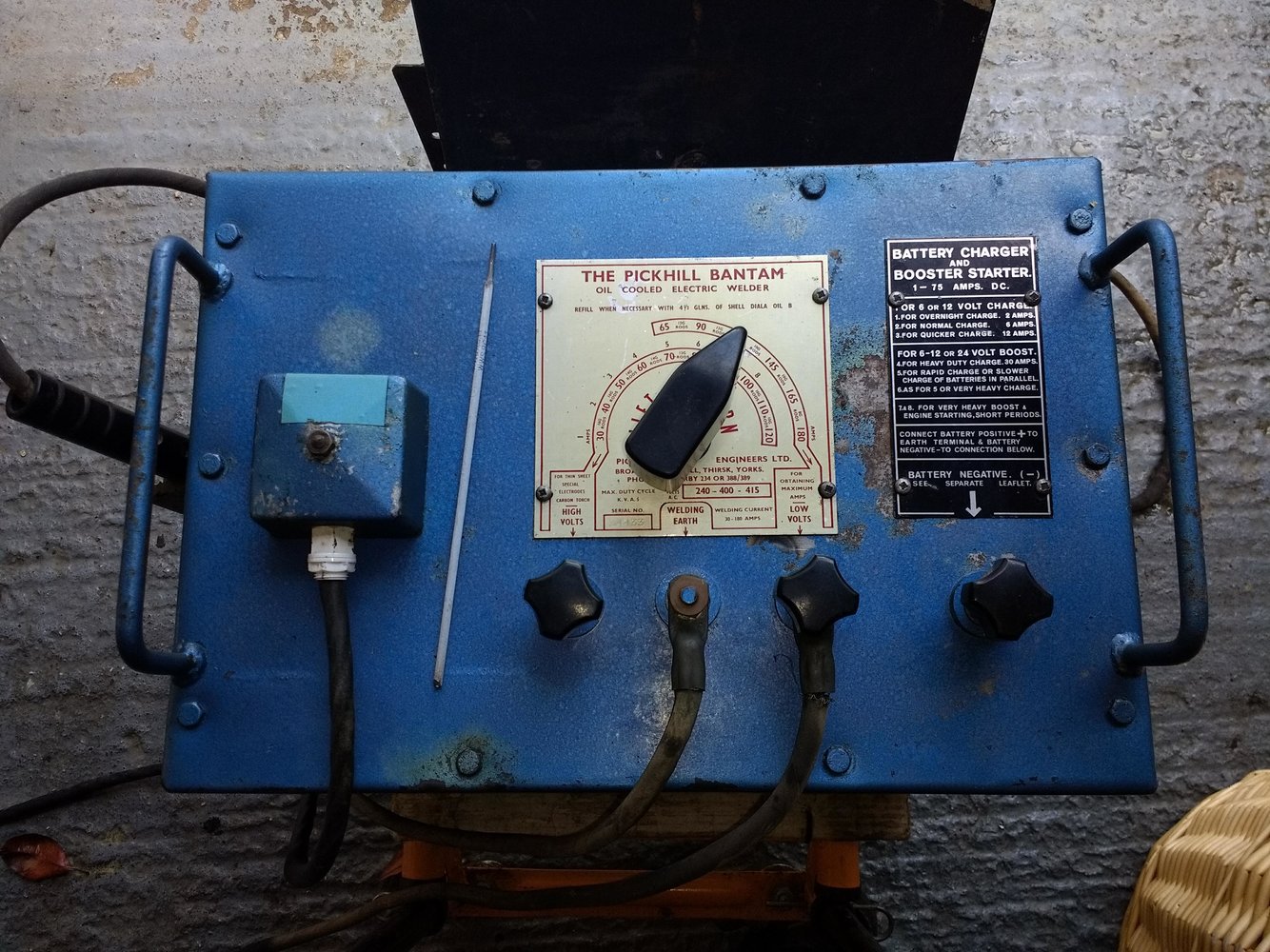

Hello - I've got a Bantam that has worked well for many years. It now trips breaker every time it is switched on. I've tried swapping to type B breakers and they still trip.I interpret your message as meaning it trips immediately on switching on, not while welding or after a certain period of time. Correct?

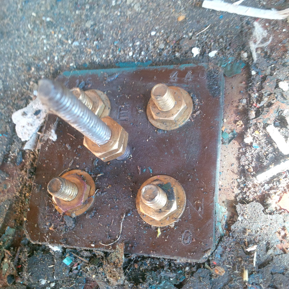

The inrush current will vary depending on which phase of the mains you happen to switch it on at. My 180A Bantam occasionally does this too, so I reset the breaker and try again. I surmise from your first message that when you wired a new mains lead on you put the live to the 230V tap (bottom left) not the 415V one, and the neutral to bottom right but it's as well to ask. The engraved labels can get filled with gunk making them unclear.

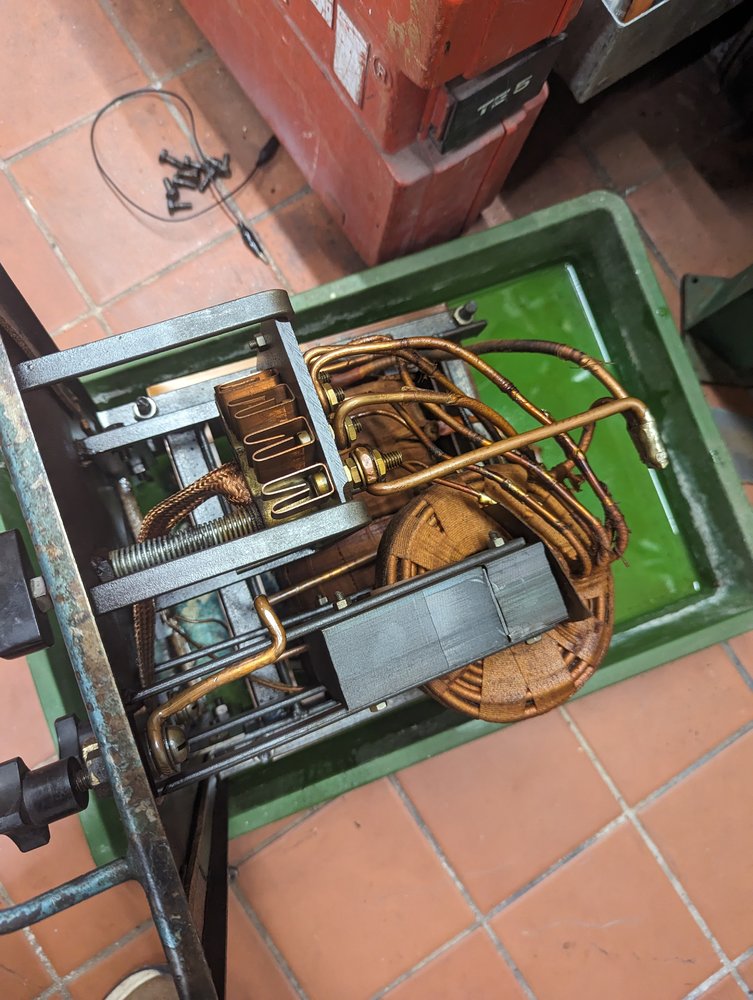

Alternatively, do you have an RCD and there is an earth leakage fault in the primary winding? If it's been abused there could be insulation breakdown, perhaps exacerbated by damp. A low DC current through the primary can drive off the moisture after a few hours and you could try again.
I've put a 16A socket off an old cooker feed, after the original 13A plug it came with was getting excessively hot. Great welder.
Cheers. I made mistake in my post. I swapped from B to C.Its a type c breaker you need.
Low oil would not cause to to trip. Low oil would cause overheating but only if the welder was working really hard.
