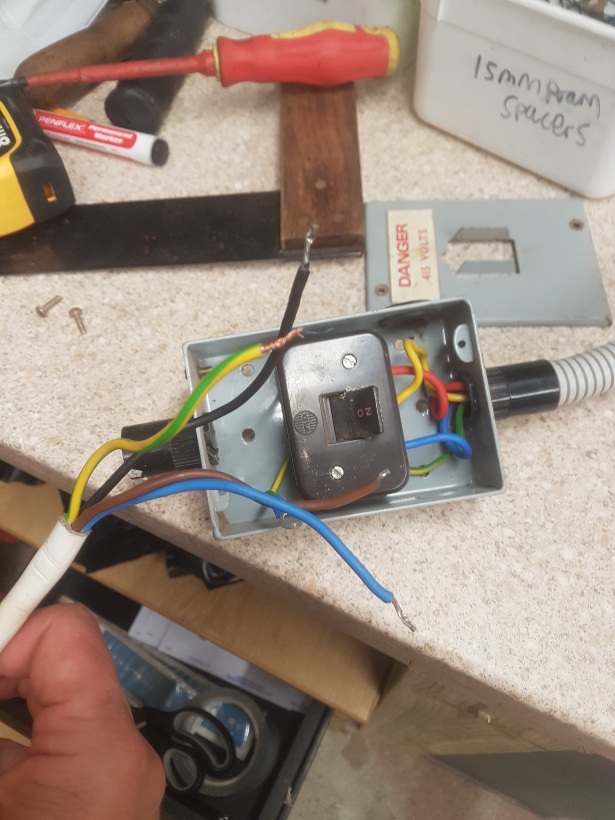

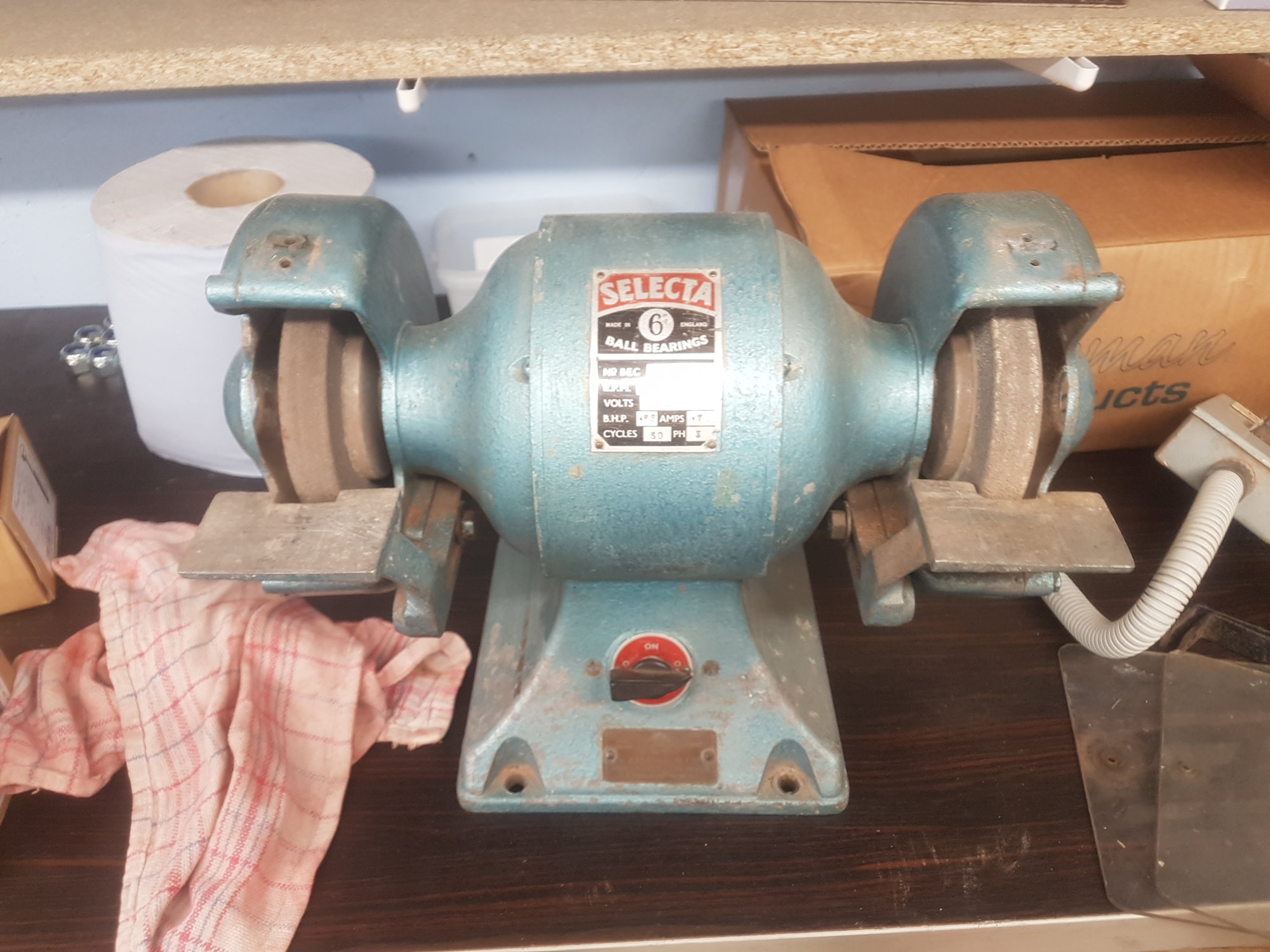

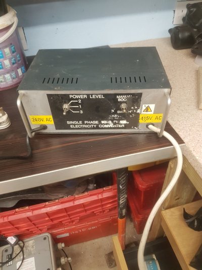

1 123hotchef Member Messages 14,347 Location Kent Jul 6, 2020 #1 Ok I am just about to wire up the new grinder to the phase converter. What colour goes with what colour please. 20200706_221132.jpg 245.6 KB · Views: 105 20200706_221129.jpg 240.9 KB · Views: 100 20200705_165405.jpg 377.2 KB · Views: 102
Seadog Save the planet. It's the only one with rum! Messages 13,090 Location NE London - UK Jul 6, 2020 #2 Connect them anywhere. If it rotates in the wrong direction reverse any two of the wires. Obviously the Green/yellow is earth. That stays put.
