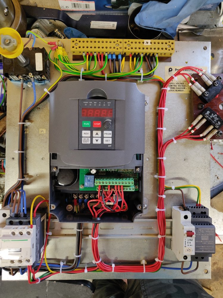

Cheers that could be really useful thanks!!The M300 is pretty easy to convert to VFD, numerous ways to do it here's mine...View attachment 315625
