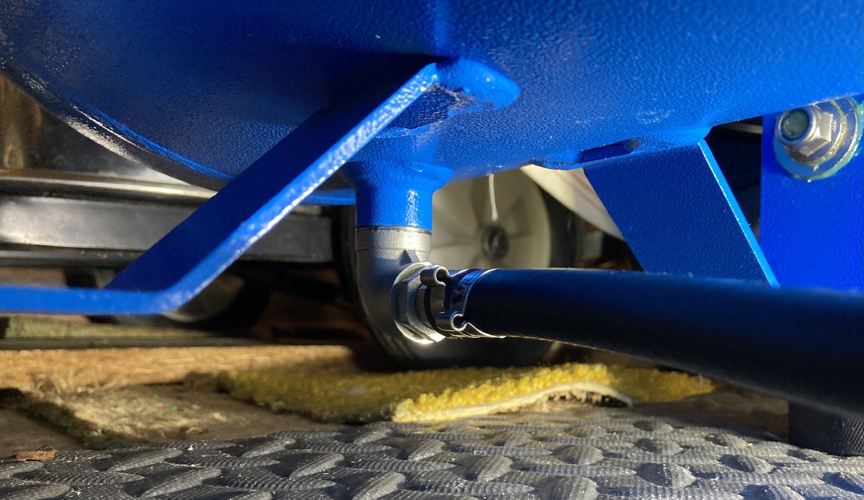

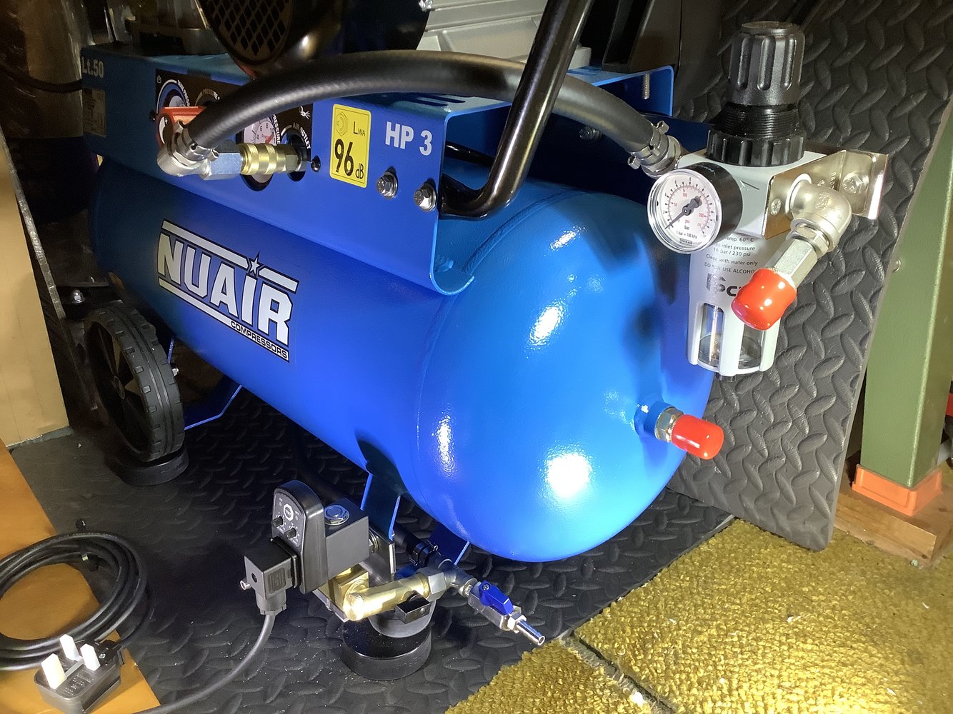

Finally completed the auto/easy access drain and the regulator/air filter.
So easy to drain off and filtered output, maintaining portability.
Just waiting for last joint sealant to set.
Just need to push on outlet hoses.
Phase 2 will be replacing with bigger wheels and thickening the front pads using hockey pucks.

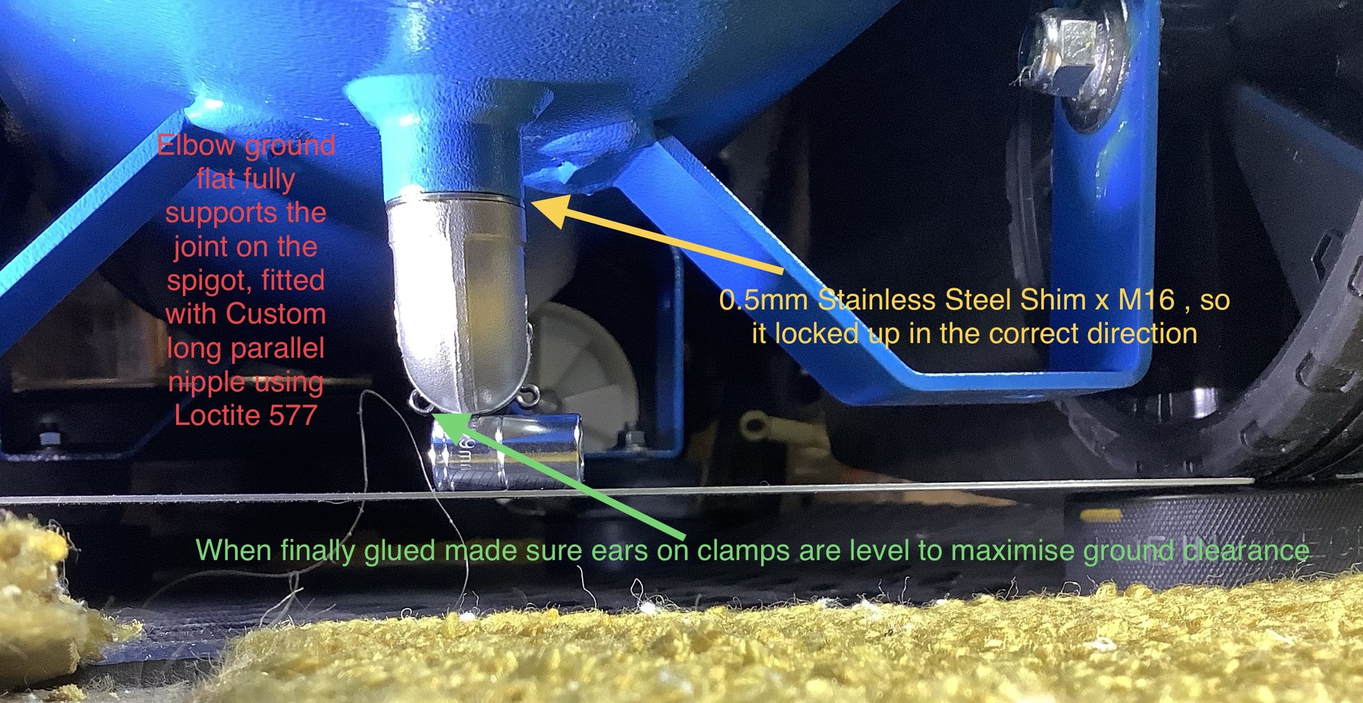

To give me more than the 13mm clearance of the drain Elbow, that replaces the std. straight unthreaded drain cock.
No more lying down, reaching to the back under the tank to turn the drain cock, that due to Sods law pointed on the other side.
