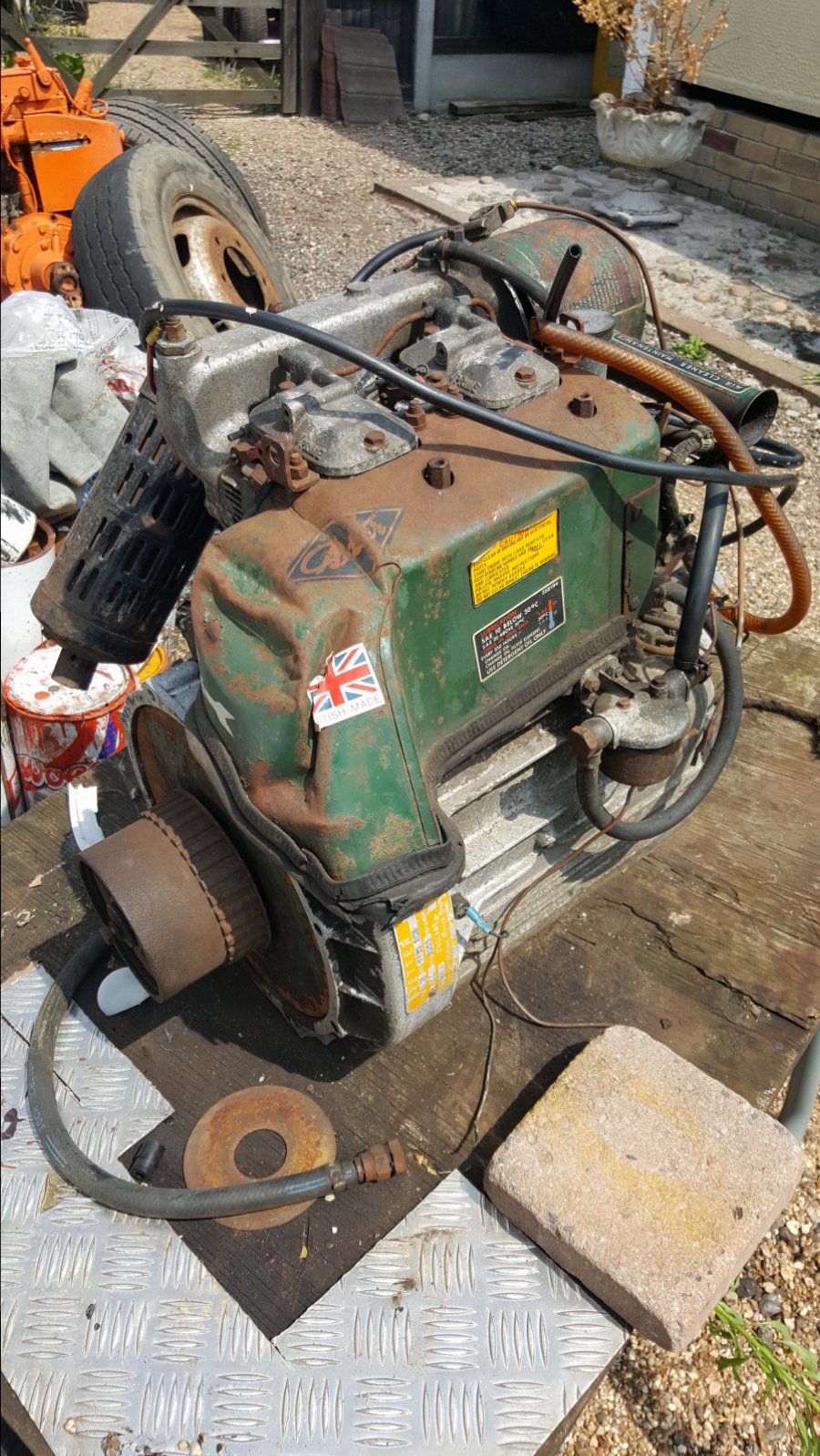

Hi guys.
Any of you guys have knowledge on petter diesel engines....
That's what I was thinking if I couldn't find a shaft of that size...The shaft is probably 25.4mm ergo 1" imperial, You could always turn a sleeve to give you the extra diameter and split it for the key,
Yes.Is the shaft detached with the four bolts?
I don't have a lathe yet. But am busting for one. I can shim the original one or machine down a bigger shaft...but might be able to get the correct diameter shaft.Make a new one on the lathe.
Yes leccy start...heater plugs ect...I hooked it up to a lorry battery. Stuck the diesel lines in a can with some diesel. A screwdriver across the starter and away it went...happy days.Leccy start?
Absolute pigs to start by hand usually.
Looks like it's got a thermostart type rig in the intake manifold.
