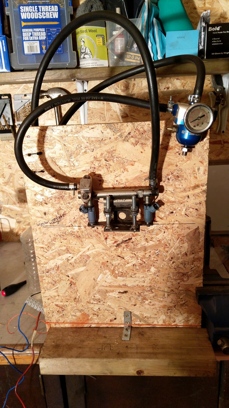

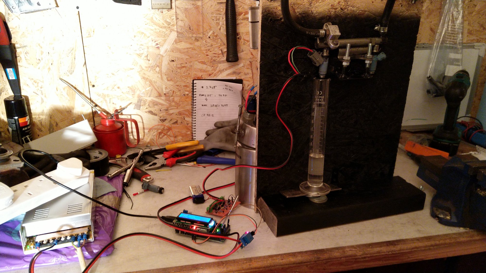

I've been working away on a computer controlled fuel injector tester lately.
I'm using an old Subaru fuel rail, with a petrol pump from a mazda MX-5, and a Fuelab pressure regulator.
The pump and injectors are controlled by an Arduino board. The injectors have a little driver circuit board, with a logic level (5v) MOSFET transistor controlling the higher voltage for the injectors.
Some in progress pics (its still work in progress)
This version is much easier to use than the one I built previously, where I used compressed air to pressurise the fuel tank, as it's much faster to change the injectors out.

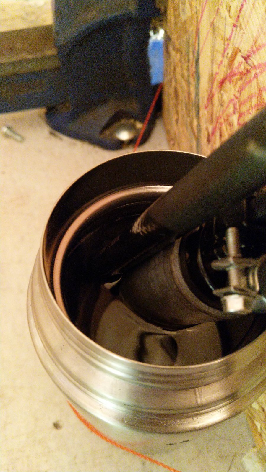

One annoyance is that any fuel spills don't drain back into a tank. I think for version 3, I will have a tank underneath the machine, and let fuel drain into it,rather than a separate tank.

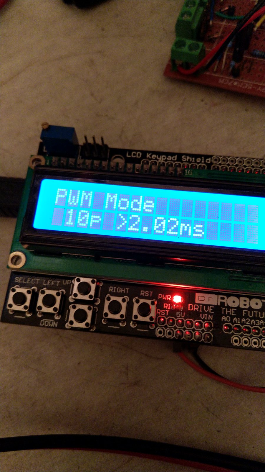

I'm using a cheap LCD shield with buttons (3.50 GBP), which works surprisingly well. The buttons are all connected to an analog pin, with different voltage ranges signifying different buttons. A bit shonky, but at least saves digital input pins.
