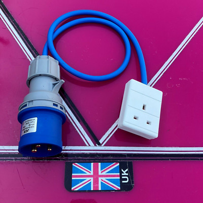

Just use a lead with 32A plug on one end and 13/16A socket on other end.
Nothing will blow up.
The 13A socket will be ok as the fuse in the plug will give suitable protection to the socket andcable, a 16A socket would be unsafe unless a 16A fuse or circuit breaker is also installed.
