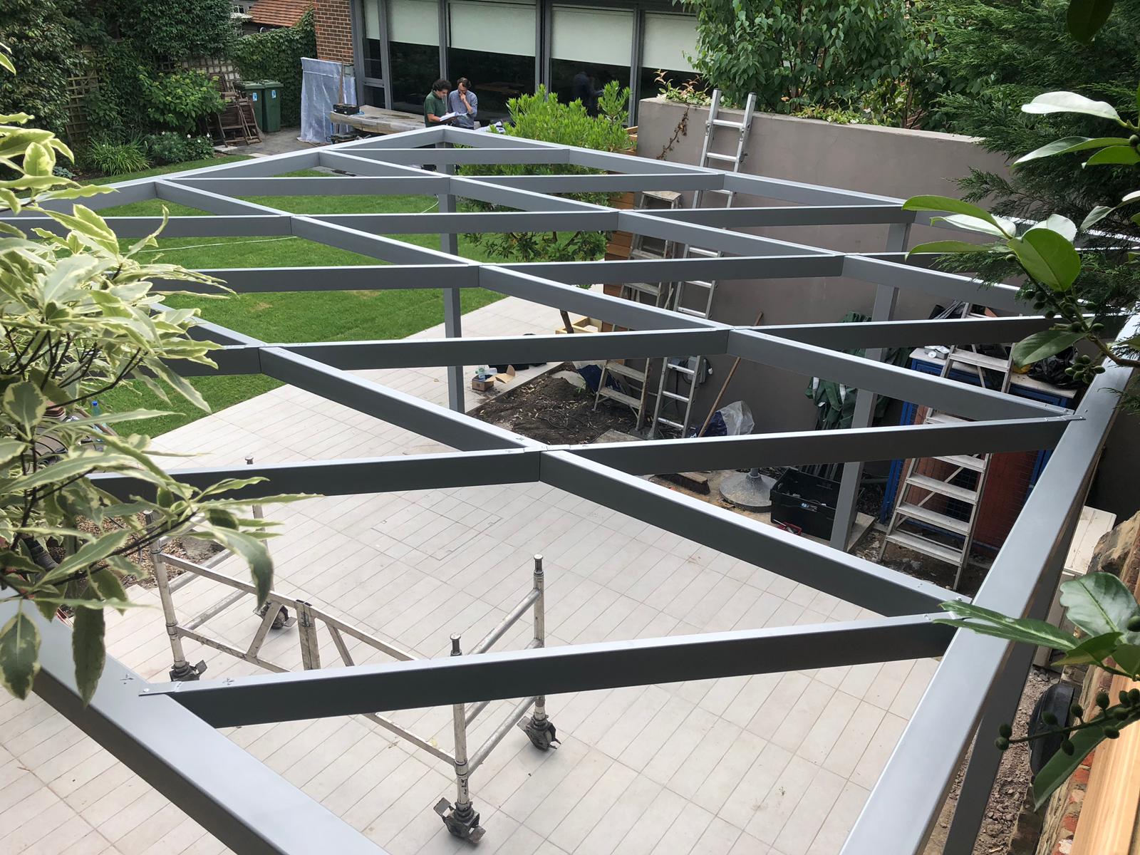

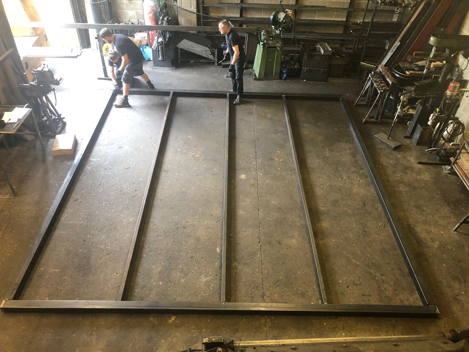

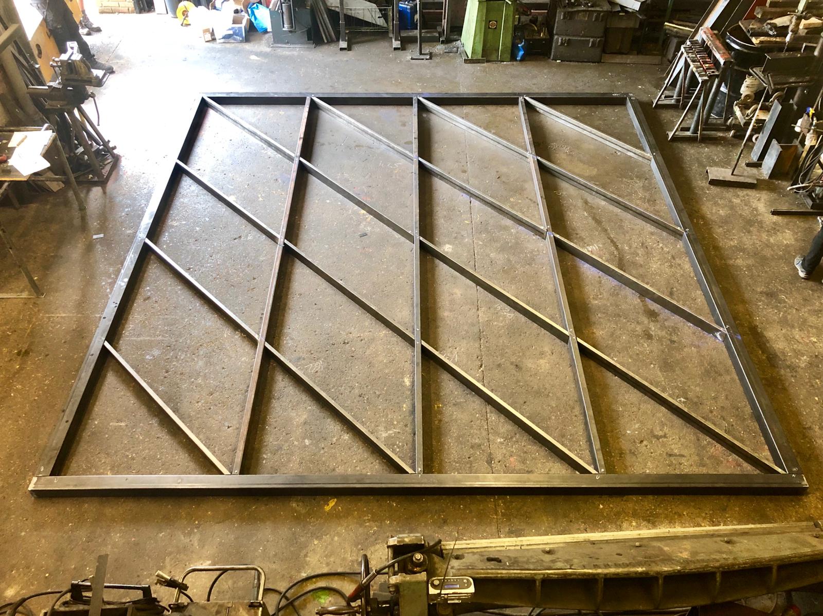

5m x 5m
6 legs 100x100x4mm
Outer frame 100x100x4mm
Horizontal bars 100x50x3mm
Diagonal bars 100x30x2mm erw
Galvanised and powder coated 7037 Dusty Grey
