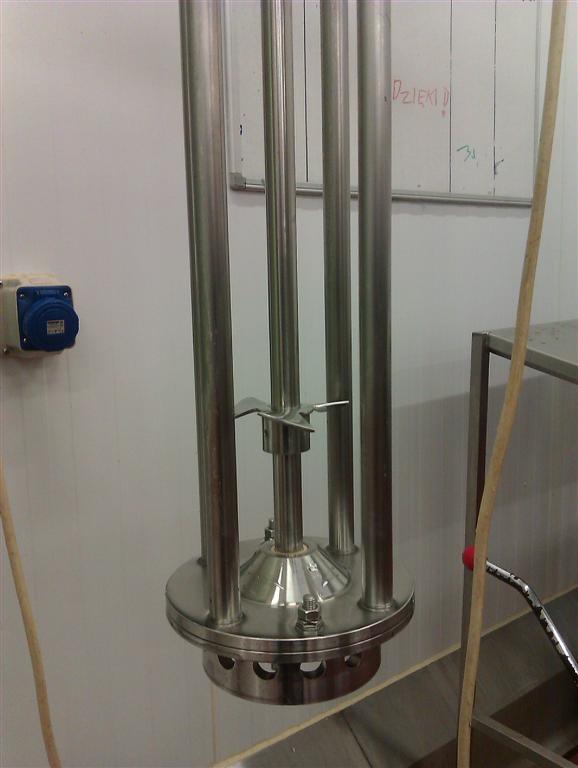

A little stainless job, this is the business end of a mixer, that impeller runs at about 1500 rpm just right for shredding fingers or anything else that it may come across, and is completely unguarded,

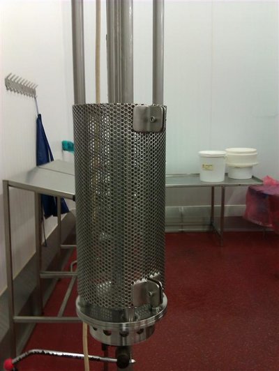

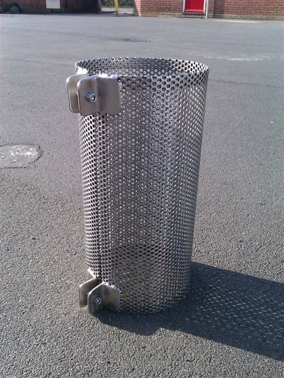

So a quick bit of bending and rolling to make a guard, and its nice and safe, the blending action is improved too, instead of just stirring the product, it pumps it through the tubular guard, in the top and out at the bottom, and a bit through the perforations.
