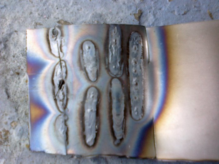

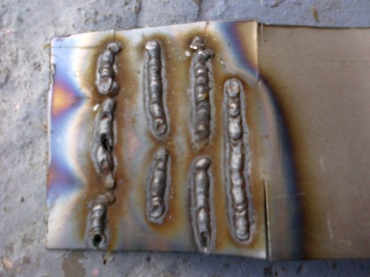

Hi I've attached a couple of pics to ask the question about penetration on the weld on the far right?
This is on 1.3mm steel, is this close to having the correct penetration?
It doesn't appear to be when I compare it to what the User Guide shows on the underside but if I leave the torch any longer it blows through.
Could it be I need to reduce the power settings and wire speed even more so I can slow down even more?
Thanks

but would like to suggest slowing down the wire speed a little, this in turn will enable you to perhaps slow the travel speed of the torch. This may allow a little more time for the weld pool to penetrate through.
