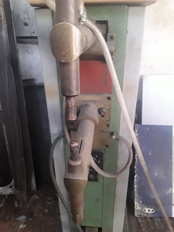

ghound Member Messages 316 Oct 15, 2019 #1 Hi, could anyone point me in the direction of spare tips for my welder? Cheers 20191015_093026-600x800.jpg 152.3 KB · Views: 150
T Tomfromuk Member Messages 51 Location Alnwick, Northumberland, UK Oct 15, 2019 #2 Both Dengensha and O'Bara manufacture machines like those, not sure if they're the best supplier of tips but might be worth a look.

C chris y Member Messages 309 Nov 7, 2019 #3 You need to remove what you have and measure up. Then compare to someones catalogue, such as Prospot - https://www.prospot.co.uk/consumables/electrodes There is no way to know what you have without measuring.

C chris y Member Messages 309 Nov 7, 2019 #4 I should have said, if you didnt know you most likely need to remove those by twisting with some grips or similar, they are probably taper fit.
