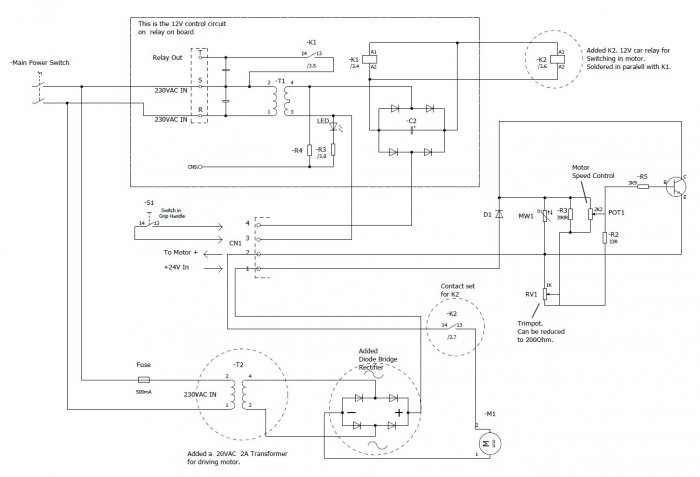

Hi everyone, first time on here so I hope I am using the system correctly. I have been trying to convert my wire feed drive to the system described by bump but I am having problems. The welder was a present from someone I did a good turn for and its three to four years old. As a fitter for many years and numerous car repair projects I thought I could mig weld until I got this "welding" machine, which seems to be a common thread. Anyway the first conversion I did was to use a 12 Volt battery charger with a Maplins speed controller, 12 volt relay powered by the original motor wires and it worked great EXCEPT there was not a big enough feed for the thick stuff and the wire kept burning back to the tip on thick aluminium.
The welder did weld the same aluminium in its original form from the manufacturer but again like someone has commented before, you could never rely on it doing it.
In order to get a faster wire feed I thought I would convert to the system outlined by bump. I had a transformer that was rated at 28 volts 9A and when I put it through a bridge it was giving 25 volts, so I thought I would chance it, but perhaps not such a wise decision with hindsight.
Now in the process of doing the first mod I coupled a wire up incorrectly and burnt out R2 and a portion of the potentiometer. I replaced the pot, R1 and R2 and the machine functioned back as the makers speck again, but when I coupled up bumps mod the motor started to work immediately the machine was switched on and R1 started smoking.
Before I started trying to trace what was up with my version of bump's mod I thought I would get back to making the machine work to the manufacturers spec and here lies the problem. I have replaced R1, R2 and the pot and checked R5 but now the original wire feed speed controller starts fast, slows down towards the center of its rotation and speeds up as it gets to maximum rotation or fully clockwise and on top of that R2 starts smoking when the weld switches are put on maximum. I have tried adjusting the pot but it doesn't solve the problem. In fact the pot has to be on near maximum to get it to run on the minimum cycle.
I would appreciate any constructive help on the matter.
