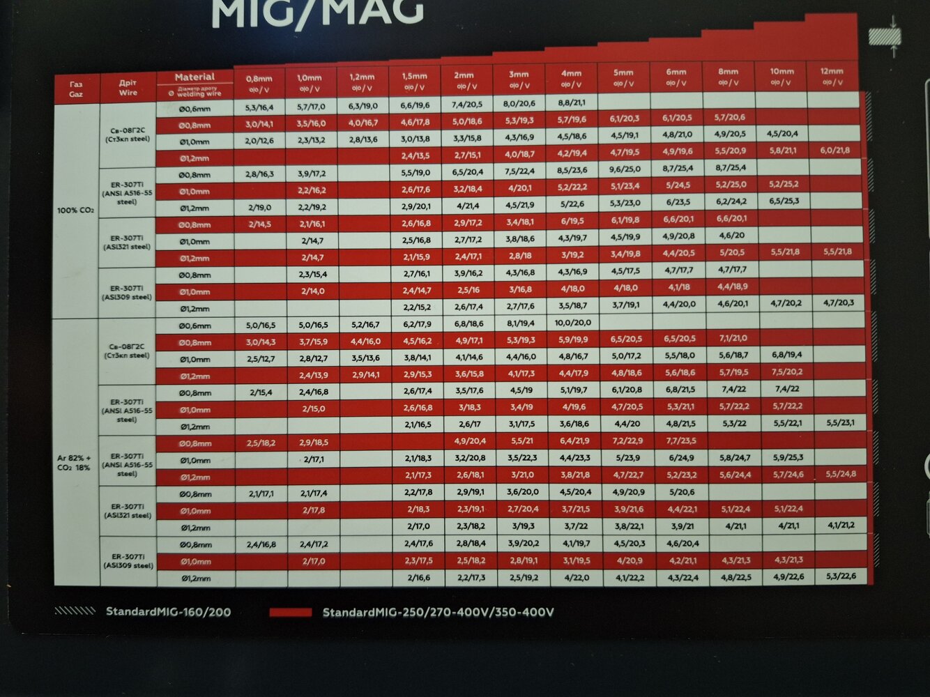

I’ve noticed on the Paton.Uk website that the Paton Standard Mig welders have been updated with rotary switches. I’ve also noticed that they now have a useful settings chart stuck to the inside of the lid.
I downloaded an old settings chart from Paton some time ago, but if anyone’s bought one of the new migs could you post a photo of the chart as it could be useful.
Thanks
