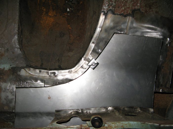

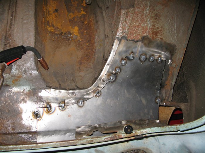

I've recently been practicing on a scrap door I have here. I tried cutting out some rusty bits and patching in some new sheet metal.
There's no going around it: I'm terrible at it.
I tried cutting out a rectangular patch now with a disc grinder and welding in a new one. Seemed like a simple exercise. I planned on making a flange to drop the patch in but a supporting beam prevents my flange-pliers from doing so.
So no alternative but to fit it and butt weld it in.
I have the greatest problem exactly fitting my patch. My nibbler will arrive soon so I only had a scissor. But how do you cut it so precise?
I tried cardboard but even then it's fitting, cutting, fitting, oops too much.
And when it finally fits... How do you keep a patch in place half way a large panel...
I've heard about screws? Screw in what, how... like between the edge of the patch and the panel? Don't I need to make a hole then ?
I need help

If you are that new to thin metal welding try practice just putting tacks and short welds on some small pieces from your scrap door (150mm x 150mm pieces) till you get your welder setup wel for thin metal.
