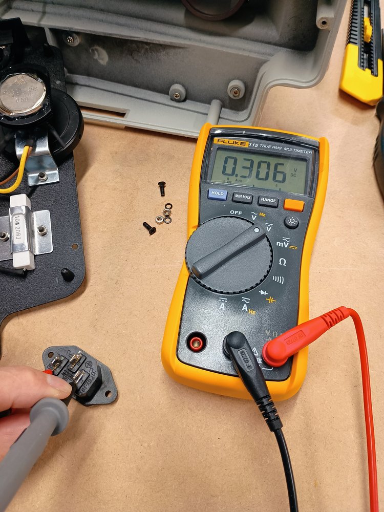

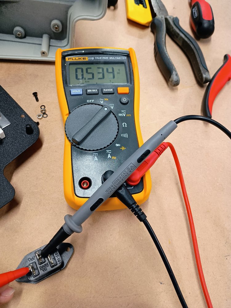

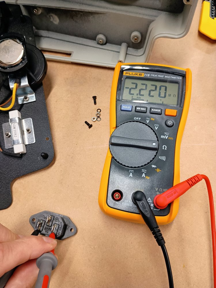

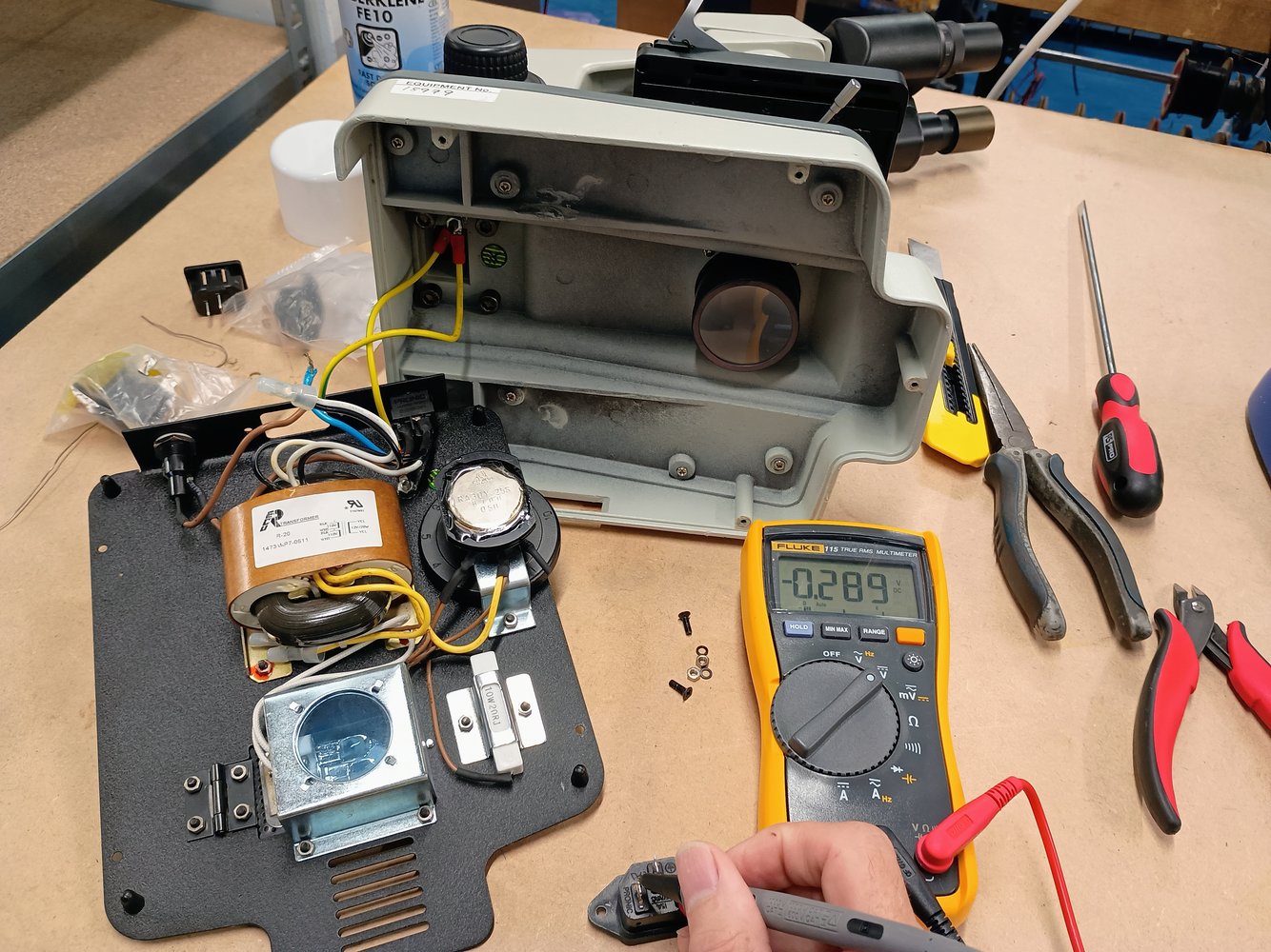

This is an unusual one, we got 5 microscopes into the workshop having failed the insulation resistance test when being PAT tested.
Our PAT tester in the lab is out of this week for calibration so had a look with a multimeter.
Now there is not much in the microscope, just a transformer and bulb. So what could go wrong.
First test was checking resistance across line and ground and neutral and ground. Both were showing ~ 8 mega ohms, but with the leads switched round they were showing a negative resistance, eh! So switched to voltage and found up to half a volt across the terminals.
That makes no sense as there is no power source in the microscope. Next I opened it up for a closer look and desoldered the iec socket.
Have a look.
Something very weird about that socket, looks like it could power a perpetual motion machine.
