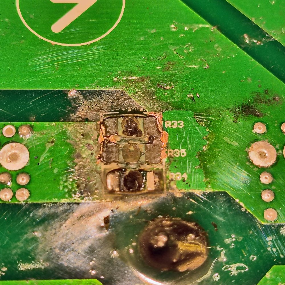

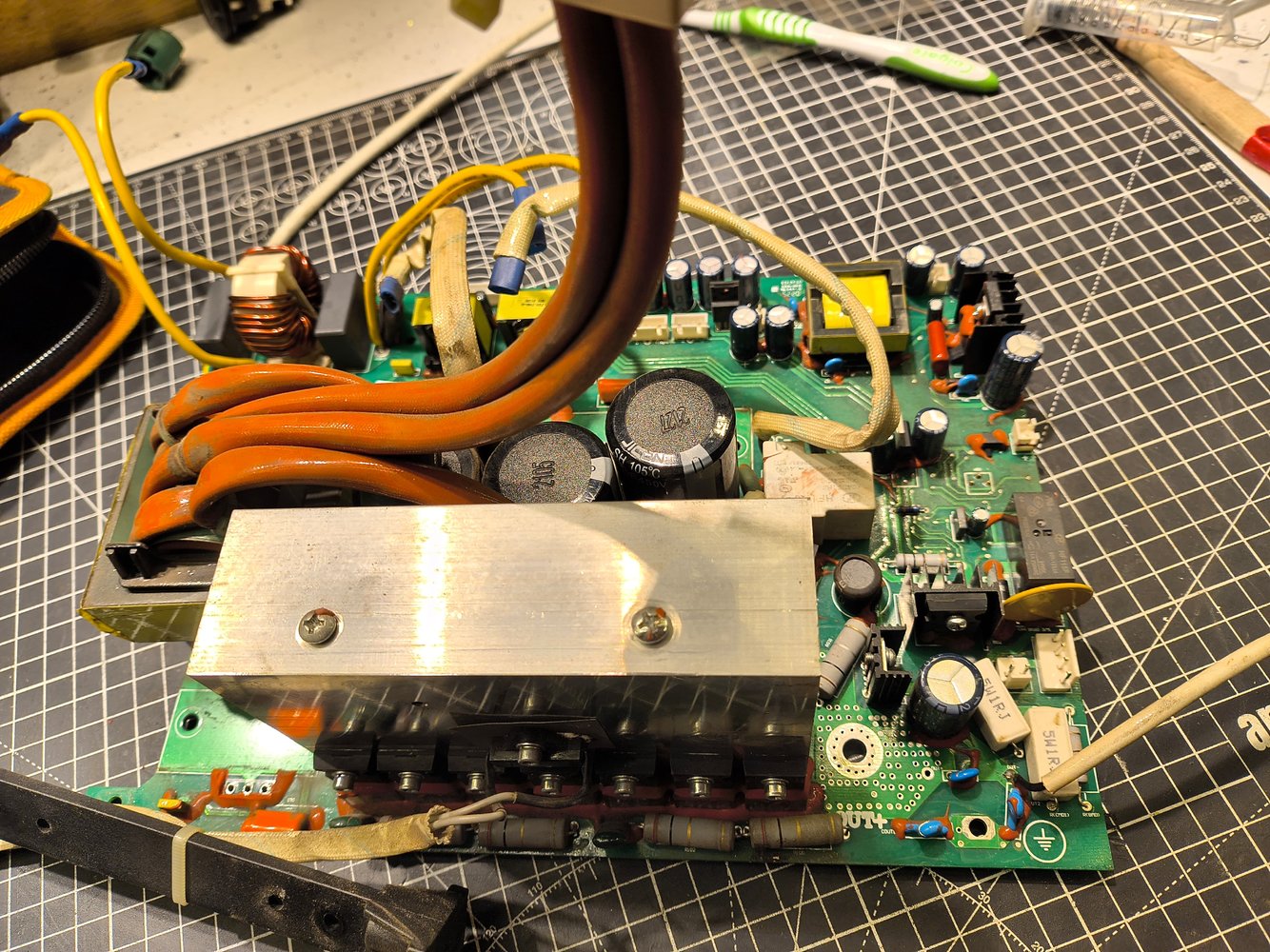

Hi Chaps, I recently bought a known faulty WWS200 MMA/lift rig welder. It doesn’t look as if it has even struck an arc as it is immaculate condition. The issue is that when plugged in the welder is completely dead. I only got it this afternoon so have only had chance to take a quick look...
