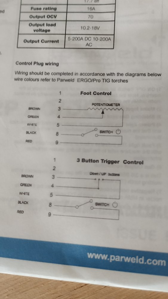

I'm have an issue with my parweld xtt202.
I have it long time but only have all the accessories, gas etc. collected recently. I've followed the instructions to a T but can't get it to start welding. Everything works on the front panel but the only actual action I can get from it is from the gas purge/flow test button.
I thought it was an issue with the switch or control wire but it tests fine for continuity across red and black at the switch and amphenol pins.
Nothing happens with the lift/scratch tig or HF start.
Could it be that I have the wrong switch and this model will only function with a 3 button? The wire diagram is for a 3 button/5 wire switch but the one I have is a single button. It is a parweld torch and switch. The switch has 5 connection on it. Is there a different way to wire it up using a single button switch?
Thanks in advance for any help.
Brian
