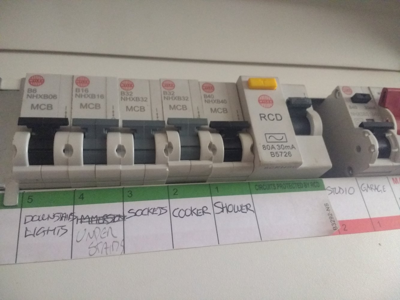

I've got volt drop here and the socket that will suffer the least is the one above.
Is it ok to take the 13a plug off my parweld xt somthing or other (hood and ruffians old unit!) and go into this breaker (with a 16a plug)?
The 13a socket next to it will only get the welder up to about 150a before it starts eating 13a fuses (it's not the welder, my mig is the same) but the one the breaker controls is on better cable anyway.
All I'm wanting to check is that it won't fry the welder. I know the circuit is rubbish - it's all going to get replaced, but I need a solution for now.
