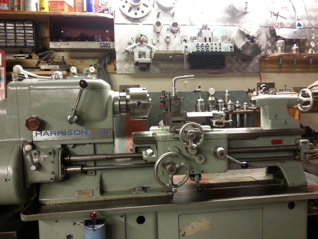

wouldnt use a dixon toolpost .a lot of overhang on them
I like that. Never thought about doing it that way.If you are forced to part something off with a long stickout, move the blade to the tailstock side of the Dixon toolpost. Then the force is going more directly downwards, closer to the compound slide pivot. At the moment, with a Dixon toolpost and a parting holder in that toolpost, the force is quite a way forward of the dovetails under both compound and cross-slides.
It does not like 4mm on my master 2500.leaning towards this myself tbh...hss and my thinner tipped seem to be fine.
