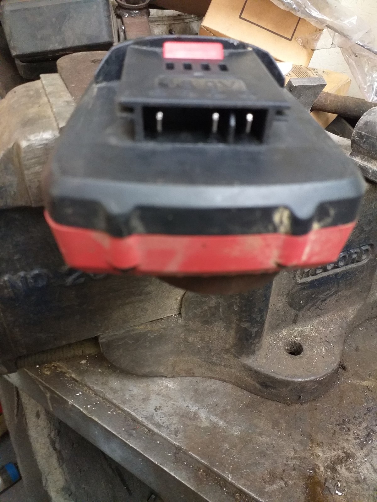

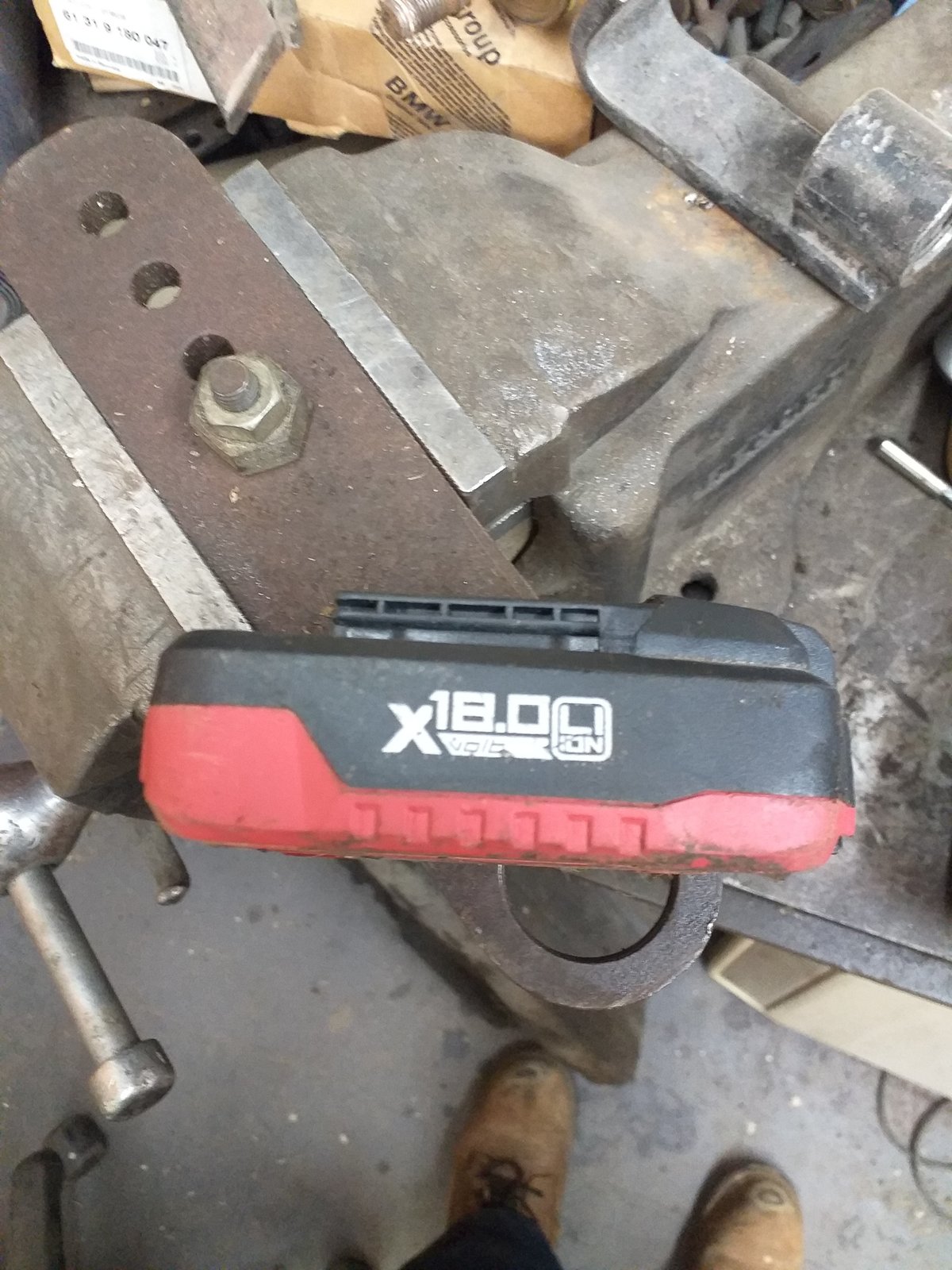

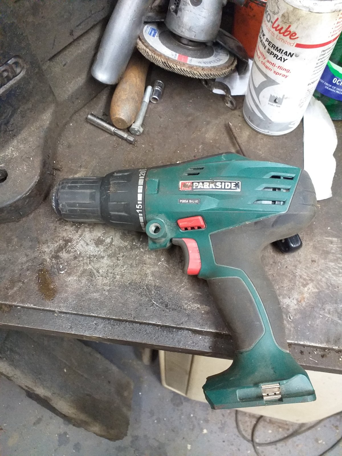

My old parkside drill, 18v Li on has suddenly stopped dead, stripped the battery and all cells show 4.17v with no load, total shows 20v no load, when you connect the drill the no load voltage drops to 15v and when you pull the trigger it goes to 0v so far so bad, what seems strange to me is that when you pull the trigger and the voltage drops to 0v all the cells still show over 4v and the total across the pack still shows around 20v but the voltage after the circuit board goes to 0v...…… must be the board above the battery??
