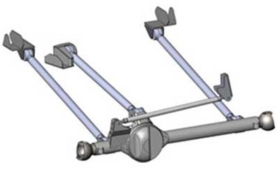

I'm designing the front suspension for my 4x4 buggy. It will have solid axles and long travel Fox off-road shocks. I'll post a drawing later once I get further with it. It will be a cross between a rock crawler and a trials buggy.
I've opted for three link suspension at the front which is your standard front solid axle setup, and has a panhard bar. I made this choice to avoid hydro steering which the more elaborate suspension requires.
I've set my anti-dive, minimised roll steer, optimised my ride height etc. Now just placing the panhard bar, which is something I've never done before.
So.... if I recall correctly.... the panhard bar needs to be the same length as the steering rod and at the same angle when viewed from the front?
What about the top view angle, does that also need to similarly follow the steering link?
Anything else to think about? I just watched a tutorial on YouTube, it talks about keeping the panhard horizontal at ride height, but that would be impossible on a serious 4x4.
Thanks in advance

How do you set anti dive with it?
