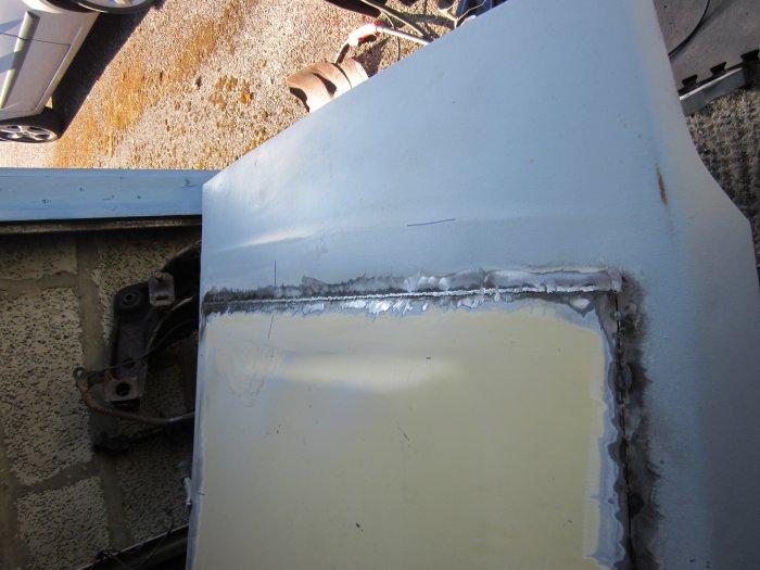

Hi all
After some thoughts on a little project. I am replacing a large part of a car bonnet and have been quite successful using thin metal technique in getting a good join without burn through or warping. The problem i am having though is a "valley" is forming along the long edge in the photo as it cools. So instead of grinding back to a flat join, i am left with a slightly depressed valley along the weld.
It is not structural, and has plenty of rigiidity, so any ideas to "flatten it out"? I am wondering if it is possible to shrink the metal perhaps to pull it up?. The other option is a smear of filler along the join (fortunately it has depressed rather than risen so quite a straight foward fill).
I estimate (using a steel rule) it is about 2-3mm at the deepest part.
Through trial and error, I think some of the issue is caused by not leaving enough of a gap in the join, and the 2 edges seem to push against eachother as they heat/cool.
So, any ideas? Thanks in advance. (Note i havent yet welded the RH edge in the photo!)
