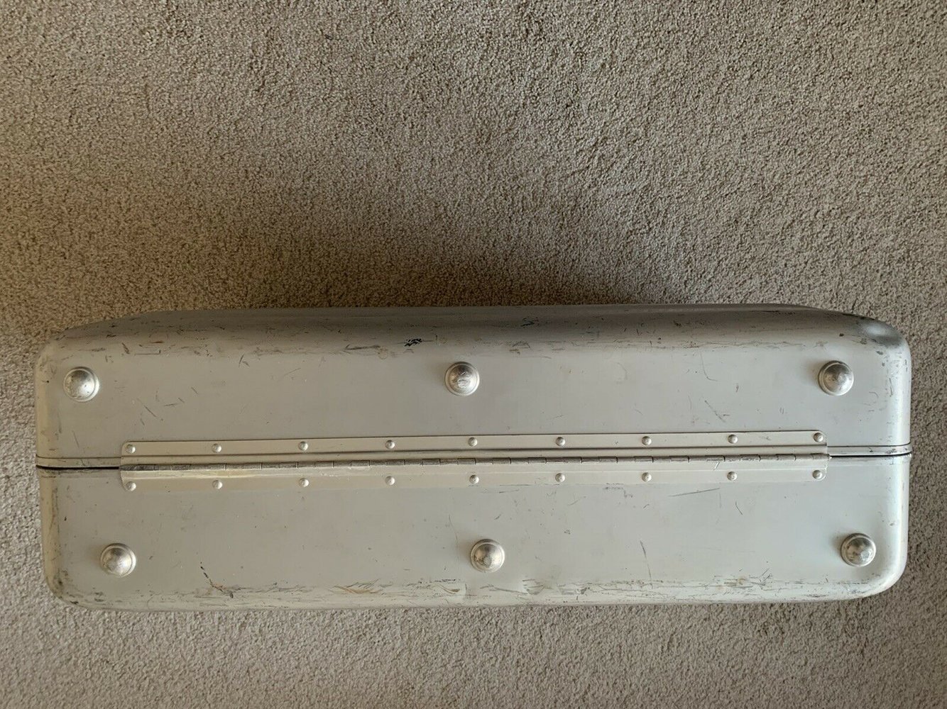

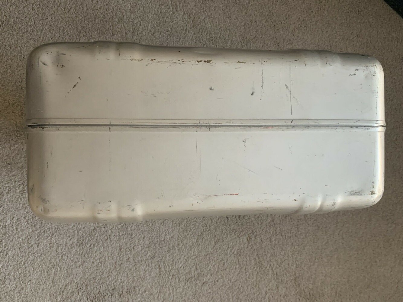

A sand bag and a bossing mallet!I would like to remove the dents from this, prior to spray -
Specifically here -
and -
I don't so much trust body filler not to just fall out, but then i have very limited experience with it.
What would be the best way to go about this?
Thank you.

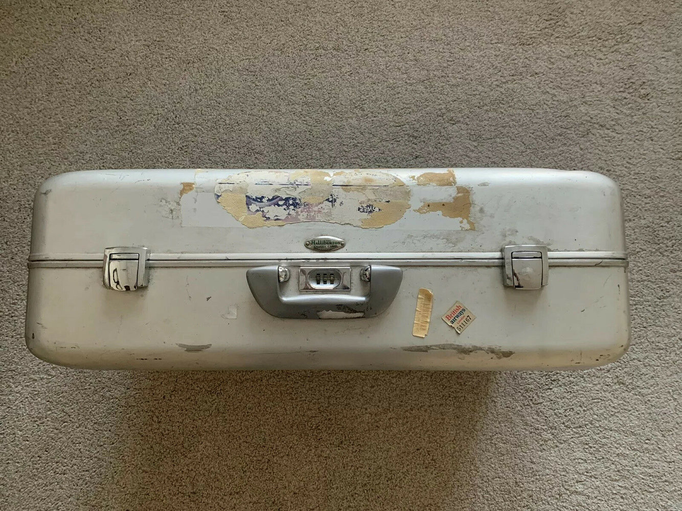

Is this case such a saleable item as to be worthy of the time and effort? Especially considering its current patinated condition may may warrant a premium of its own?
If you are painting then filler?![]()
I'm not sure how tough filler is? I really have no experience of it.
I'm guessing it doesn't just fall out, but I'm just dubious of filling the corners of a suitcase.
Depends how good you key is and what filler your using.I was concerned about the aluminium - most stuff does not stick to it well at all.
