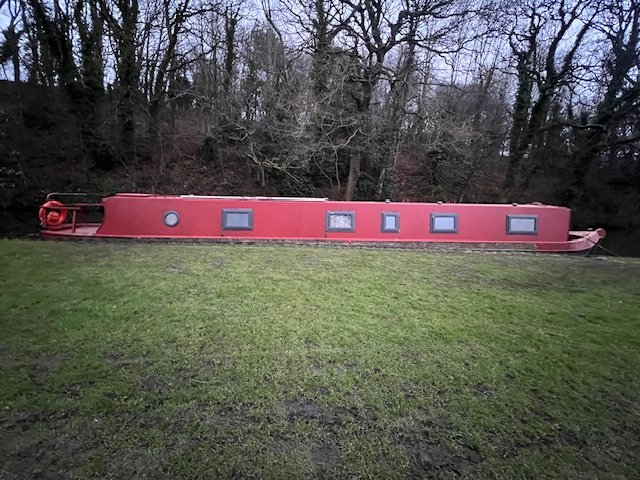

If it were mine, I would weld but only small tacks then flap disc the tacks flush, fill with a metal based 2 part filler, sand & paint.
With the windows out to expose the opening you'll be able to slide a sheet of tin or something down the back to stop direct contact with any insulation (had it been spray foamed?) and with small tacks in the 3 or 4mm cabin sides, there'll be barely any heat anyway. Bucket of water & a sponge or a spray bottle on hand just in case. Give the tacks time to cool a bit before adding more, start with a tack on each of the outer edges & work in towards the apex of the corner.
Most of the shaping of the radius can be done before tacking in place to save grinding sparks in situ.
If there is any slight deformation a tap with the hammer will sort it.
Should be fine.
