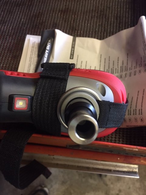

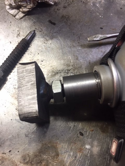

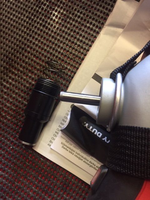

Went to see a panel man to learn something about ali bashing he showed me this tool he made up so it had to be done.I made up an adapter for the machine so the hammer power could be adjusted to tame it down. got to make some more ends for it. but it works well.
