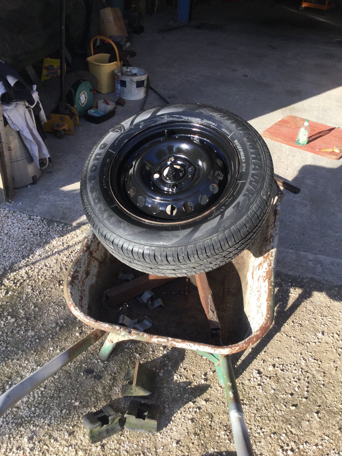

been doing quite a lot, these last weeks........got fed up with the masking off.......
so just thought, to protect the tyres from the paint why not use something else.....?
decided to try liquid soap, u know washing up liquid.....works for me, paint don't stick at all......
obviousley the soap needs to be wet, just did 1 rim at a time....(all rims prev prepped)...
I used a 3" paint brush.......
just the first coat of paint......

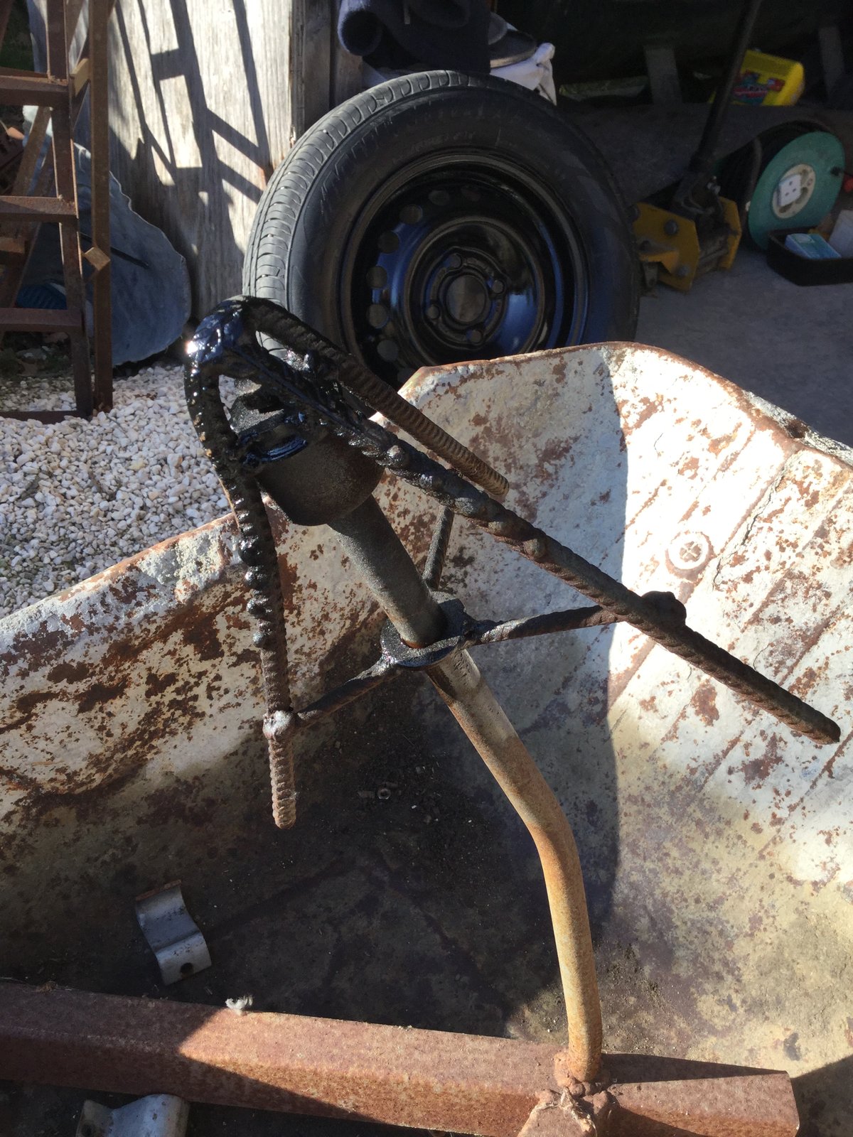

this is my wheel spinner, works a treat......
hope this may help somebody out......?
