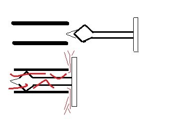

The Unistrut profile is like this -
Any can anyone give me tips on how to get paint into the hidden recess ? Only thing I can think of is before installation holding the channel so gap / recess is downwards and then pouring small amount of paint into the recess and allowing it to run down back into the tin.
Thanks.
